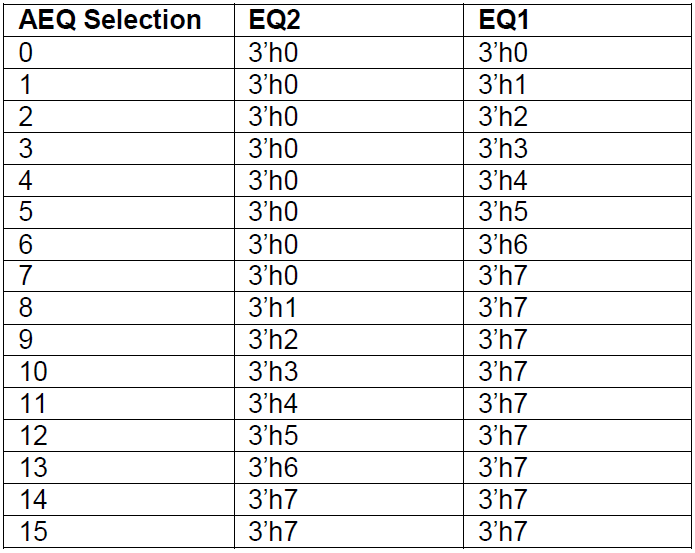

There is a description of "AEQ full range 0x00 to 0x3F" in the column of PIN OR Freqency in section 7.6 AC Electrical Characteristics tDDLT (Deserializer data lock time) in the data sheet.
I think that "AEQ full range" means all equalizer level.
But AEQ has only 16 step, in case of 0x00 to 0x3F, it becomes 64steps.
Please tell me the correct meaning of "AEQ full range 0x00 to 0x3F".
