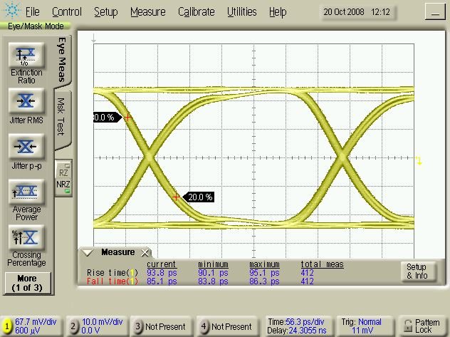

Hi all,
we are using LMH0303 to convert 3G-SDI 100ohm differential signal to 75ohm single-ended output.
We have an issue with the output signal (bad eye diagram).
As first we had suspicions that an impedance mismatch could generate those problems, so now we have removed most of the output components (L-R) from the original configuration and leave only a simple 75R on both outputs.
This is the actual configuration:
Components are placed near the cable driver, with short traces.
This should be the best impedance matching on LMH030 output but, even with this configuration, the waveform presents a ringing that creates undershoot on the center of the eye diagram.
What could be the reason for this behavior?
