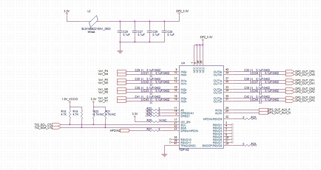

I request a design review for TDP142.
and I check a configuration of below

Hi Louis,
You can reference this schematic checklist to review your design: https://www.ti.com/lit/an/slla463/slla463.pdf
I would recommend a bulky 4.7 uF or greater bulk capacitor on VCC. Additionally, the resistor on DPEN/HPDIN should be 10k.

Hi Louis,
The resistor is more for current limiting.
If you are having issues with the device you can reference this FAQ to help with debugging: https://e2e.ti.com/support/interface/f/138/t/807658
