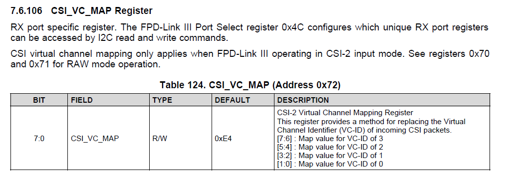

My customer cannot under how to configure the 0,1, 2,3 based on the virtual channel. Could you please share more details about it? Thanks.

Frank,
this means you can change/change/change the input VC-ID from snesor and re-generate the VC-ID in the CSI2 output of UB954.
every 2bits is used to map the VC-ID from 0 to 3 respectively.
