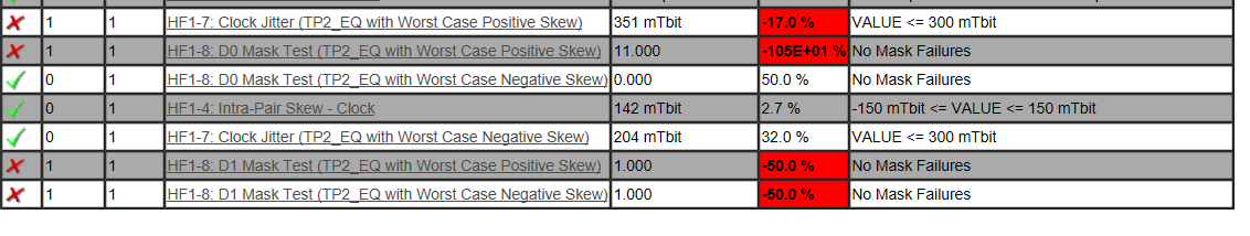

Customer use TMDS181 to design a product. When they test the HDMI function, Some test items failed. How they can optimize them by adjust TMDS181 design ? thanks

Closing thread as resolved over email. Solution was to use 75 to 150ohm termination for HDMI2.0 (Reg0Bh[4:3]) and 2dB de-emphasis (reg0Ch[1:0]).
