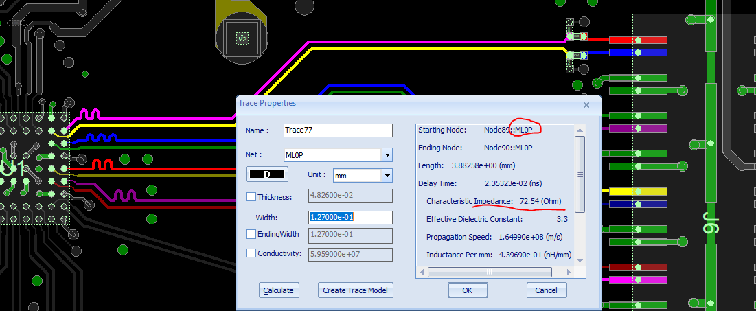

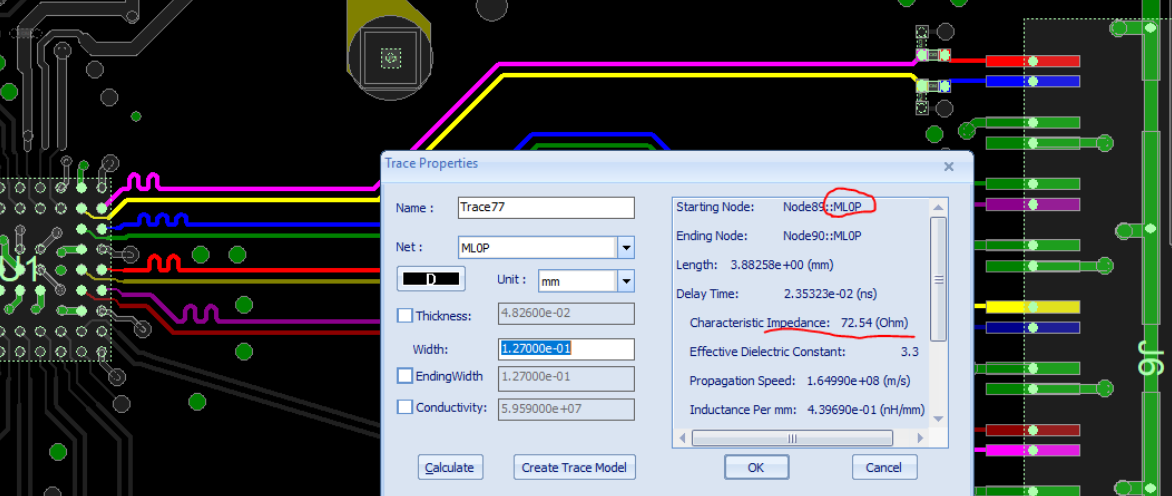

Hi David:
The SN65DSI86 impedance spec define:
Single-ended= 50-Ω (±15%)
Differential= 100-Ω (±20%)
We're using board file and default stackup to check main link impedance. But single-ended impedance was found to be out of spec. (Differential is right)
Is this an alternative? Or both need to meets?
Thank you~
Joe
Please follow the DSI86 datasheet and hardware design guide: http://www.ti.com/lit/an/slla343/slla343.pdf.
DA*P/N and DB*P/N pairs should be routed with controlled 100-Ω differential impedance (±20%) or 50-Ω single-ended impedance (±15%).
ML*P/N pairs should be routed with controlled 100-Ω differential impedance (±20%) or 50-Ω single-ended impedance (±15%).

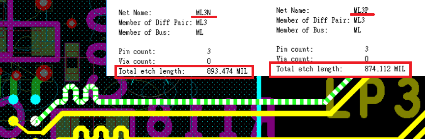

I don't know why the EVM was initially designed with 20mil intra-pair skew. But I would design the board with the recommended 5mil intra-pair skew.
