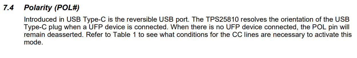

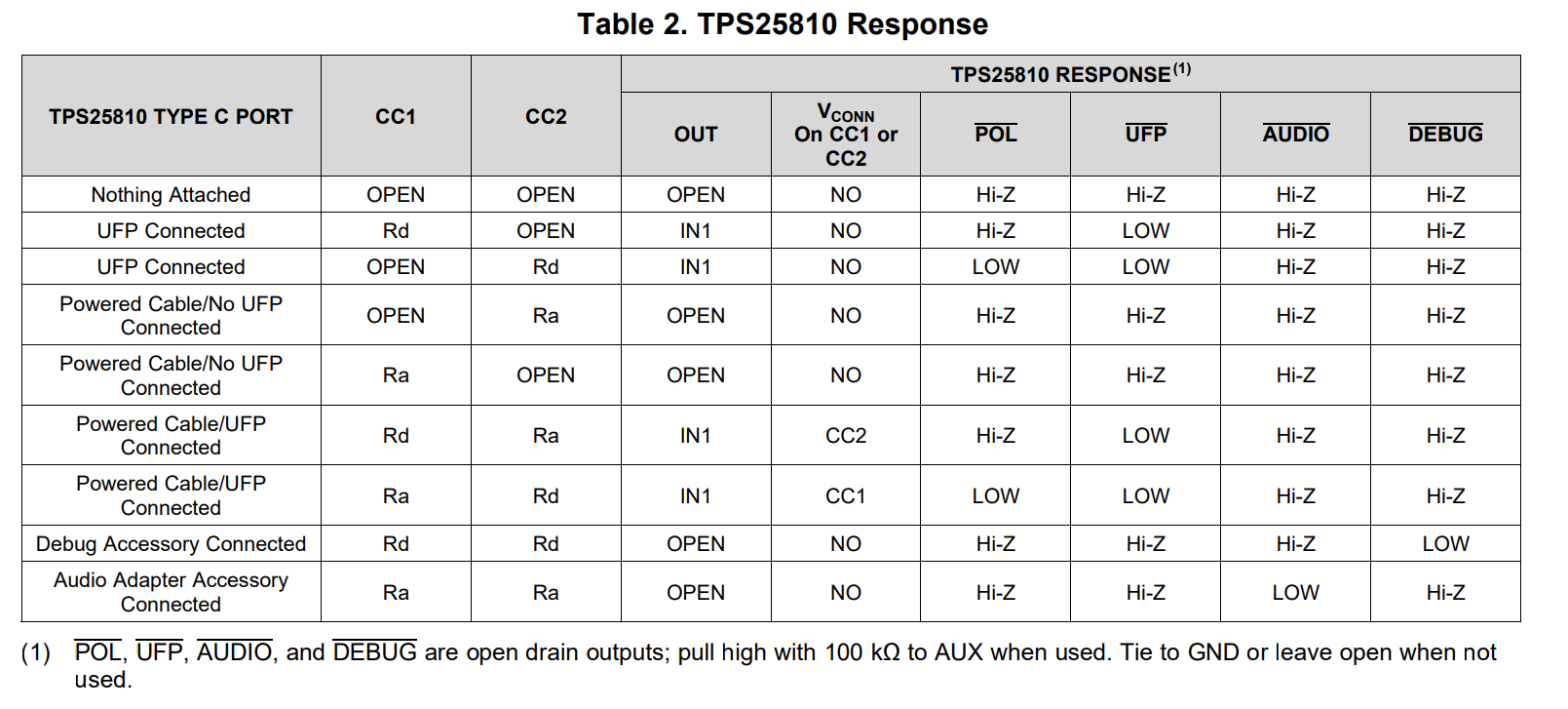

- When SEL is connected to POL, straight connection, one of the orientations work, (SEL being low).
- When SEL is connected to POL, with a 10k pull up resistor, nothing works.
Does TPS25810 recognise USB 3.0? (5Gbps)
If positive, why is this chip not working?
