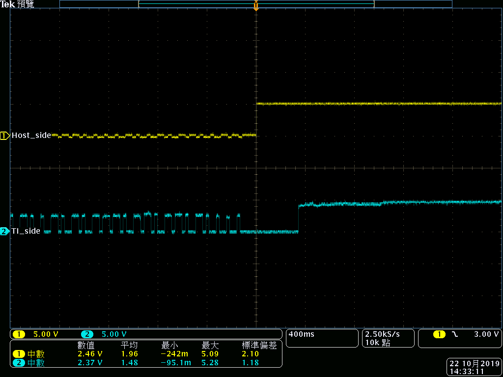

Hi Sir,
please see the attached file,
Ch1=ZBook VCONN Voltage.
CH2=TPS65982 VCONN Voltage.
Hello, As we suspected, Cable electronics is not getting VCON in the failing case. Host supplies VCON only for a short period of time and turns it off after that. Whereas, in the passing case Host provides VCON throughout. A source requires confirmation from the cable before supplying 5A. In this case, TI controller continues with 3A as it is not getting any response from the cable.

Hi, This is host side issue and we cannot fix it from Dock side.
Prajith
