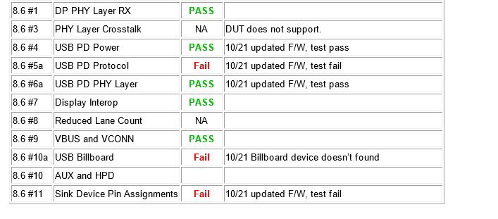

Hello

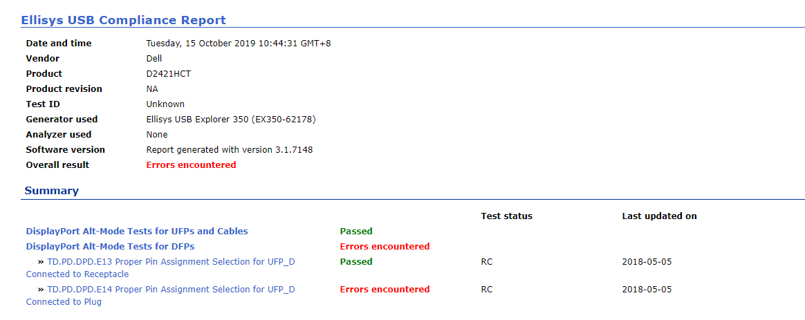

       Customer device is monitor. Below PD compliance testing fail items. How to modify project file and VIF file to pass it? Thank you.
OTS_0820_B_1018.pjt

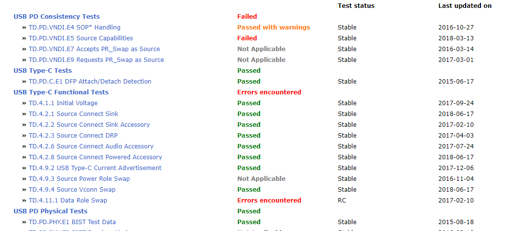

  • Hello Patrick,
    I believe this is related to thread #848070. So, please post your further queries on #848070 thread since this one has been marked as closed.
    Here are some of the analyses for your compliance failures.

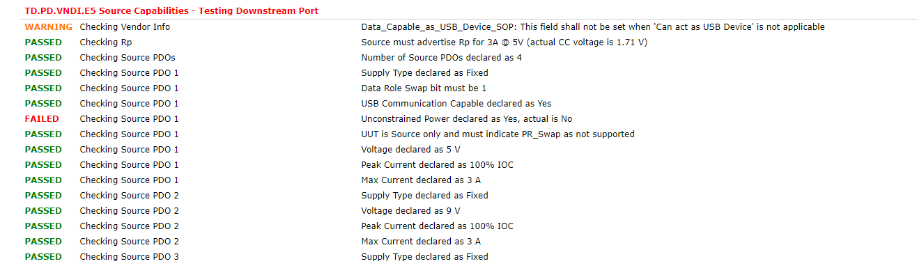

    TD.PD.VNDI.E5: Try to run your test with the setting "Externally Powered" (bit #19 in register 0x29) as true.

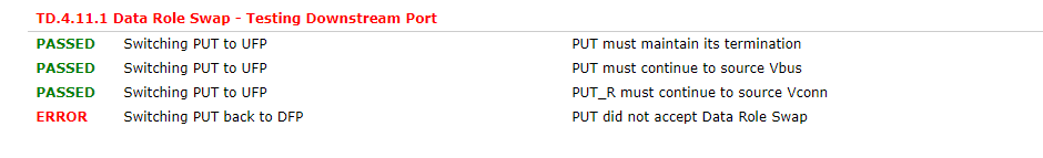

    TD.4.11.1:  The DR_Swap here is not enabled for UFP->DFP. This can be enabled by setting bit #15 in register 0x29.

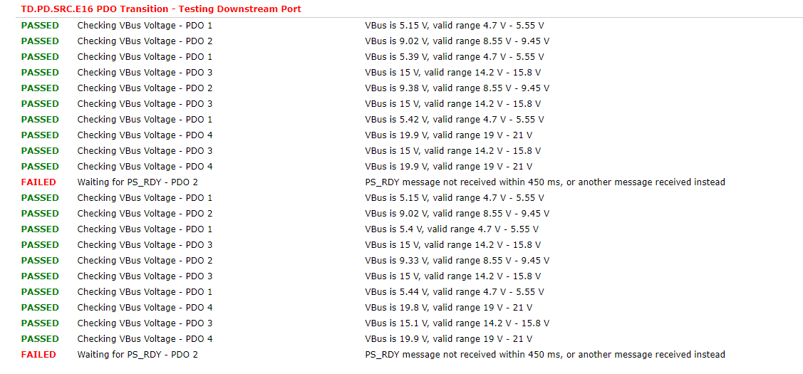

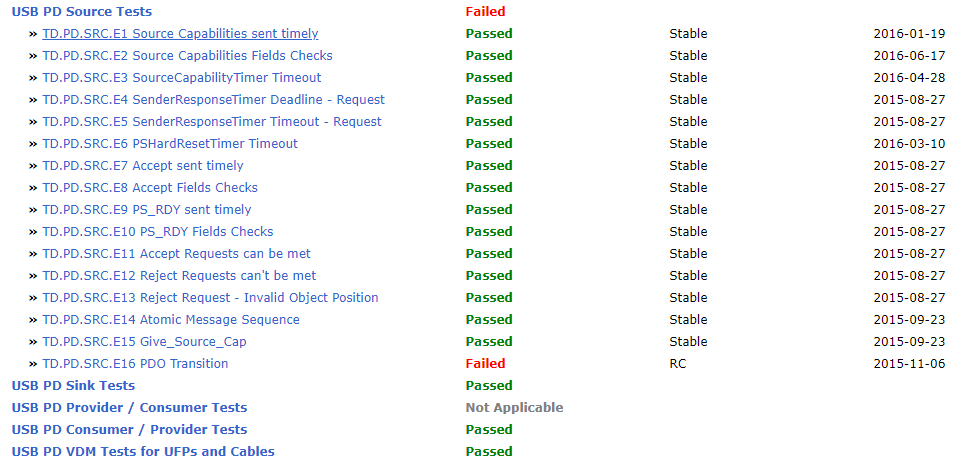

    TD.PD.SRC.E16: Require PD Analyzer logs to investigate further.

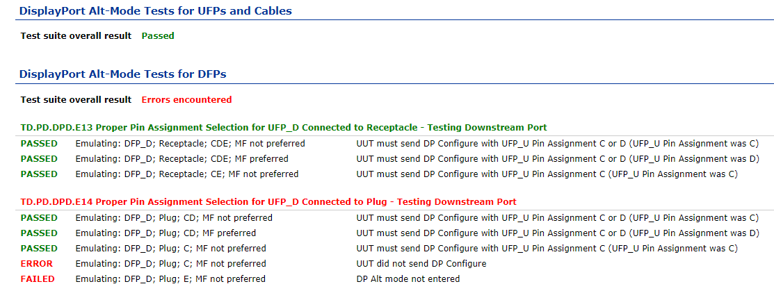

    TD.PD.DPD.E14: Require PD Analyzer logs to investigate further.
    Kedar
