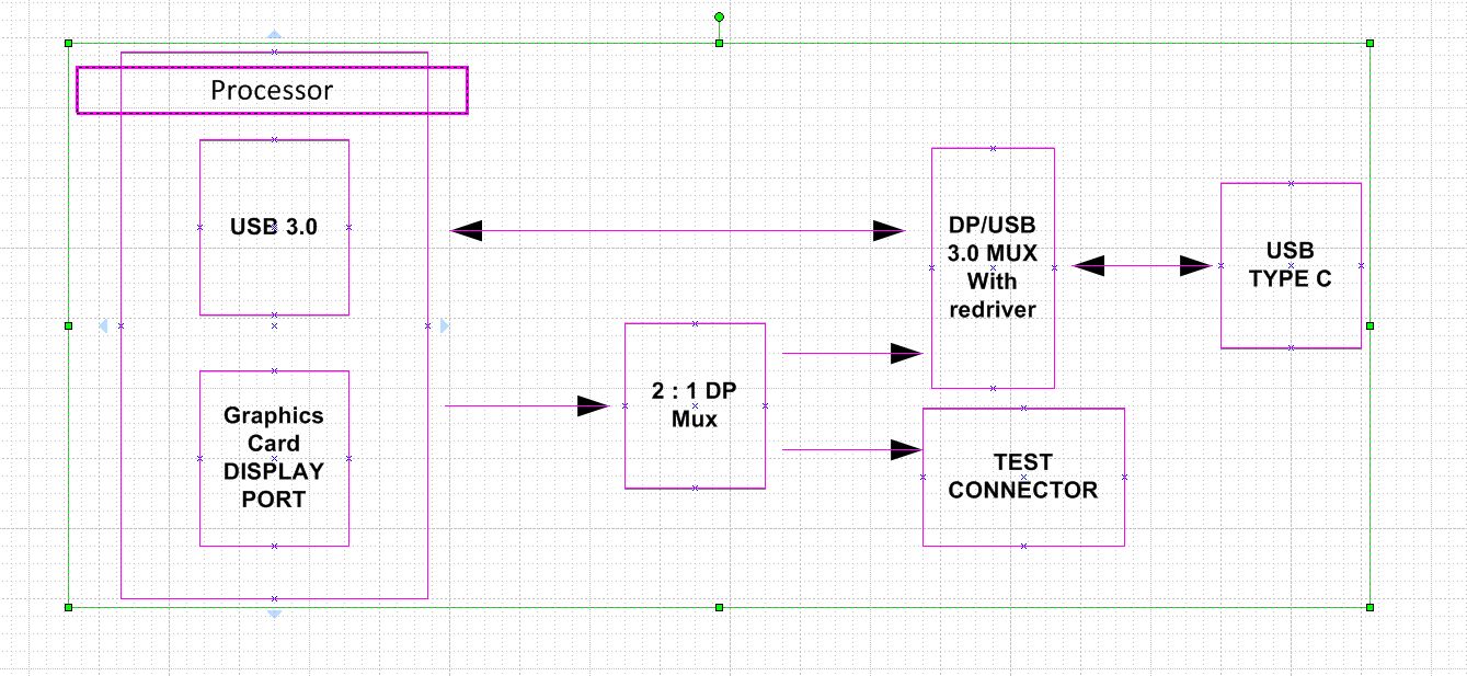

I have a USB type C application and am using a USB type C PD controller. The evaluation schematic (Different vendor than TI) shows a DP/USB mux with redriver but it only works till 5 GBPS. Their 10 gbps is not I-temp rated. I would like to use TUSB1046AI-DCI.
The flow of direction is Host (USB/DP) --> MUX --> USB type C connector (DFP) --> Monitor (Display)
