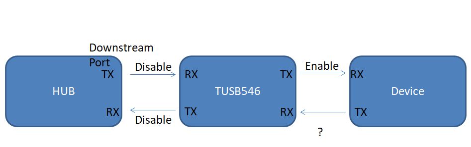

I'm encountering an issue revolves around never regaining connection to a downstream device at the port controller by the TPS65981 after the upstream connection is lost and re-established. For instance, in the diagram below if you disconnect and reconnect cable 1 the host will usually not rediscover the device. However, if cable 1 is connected prior to connecting cable 2, there isn’t any issue. In a failure condition I can only recovery by reconnecting the device at the DFP.
Host <-----cable 1-----> UFP <-> Hub(TUSB8041) <-> DFP (TUSB546-DCI controlled by TPS65981) <-----cable 2-----> Device

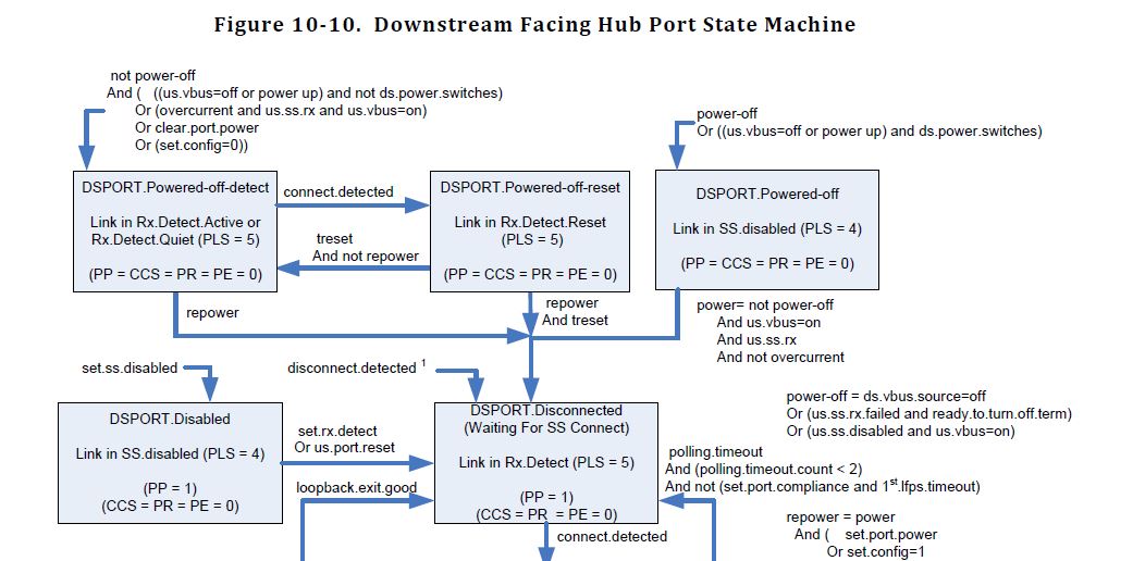

There are 3 other DFPs coming off this hub, which all use a different mux/controller (HD3SS3220). None of these DFPs experience this issue. Additionally, the problem has been observed with multiple hosts and devices. In fact, the problem seems to be somewhat dependent on a race condition in some form. For instance, I can reliably replicate problem when plugged directly into the host, which is a laptop, but when I route it through the laptop dock I don’t see an issue. Additionally, there have been a very small number of instances when the device is rediscovered after a UFP reconnect in a previously failing case.
I have checked the DFP mux and it maintains it's correct orientation when the UFP is disconnected. Nothing seems strange here.
