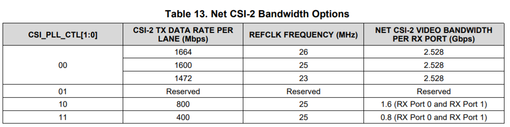

Hi Team,
The first page of datasheet tells DS90UB936-Q1 can support 1.5Gbps, however, register setting doesn't have the option for 1.5Gbps. Could you please help confirm if it can support 1.5Gbps? If so, how to set for register?
Thanks and Best Regards!
Hao
