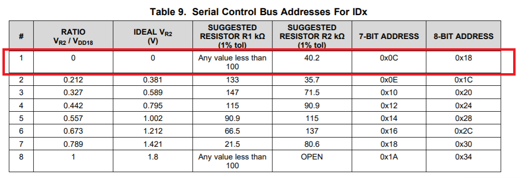

Would you review table 9 of the datasheet for IDx configuration
For address 0x0c, what resister should i use for R1? thanks!

That is a typo - R1 should be OPEN and R2 can be any value < 100kOhm.
40.2kOhm would be a good choice for the pulldown.
