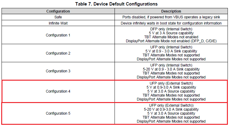

Hi Team,

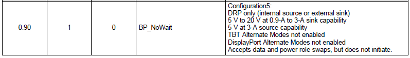

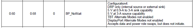

I found there is inconsistent despriction about configuration 4 and 5 between the following application note and datasheet.
-TPS65987 and TPS65988 SPI Less Host Programming Over I2C (page 3-4)
http://www.ti.com/jp/lit/an/slva972a/slva972a.pdf
-TPS65987D datasheet (page 42)
http://www.ti.com/jp/lit/ds/symlink/tps65987d.pdf
Which is the correct?
