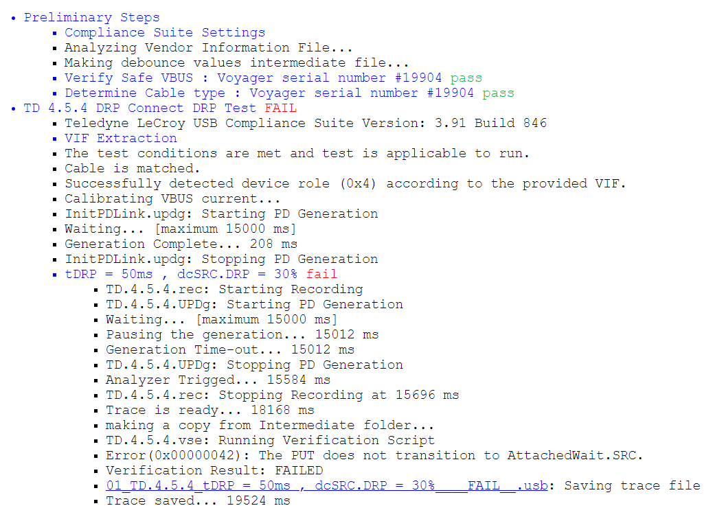

We use TUSB320 IC to achieve DRP function. and submit product for USB-IF testing.
The attachment is error report. What is the cause of the error and how to resole it ?

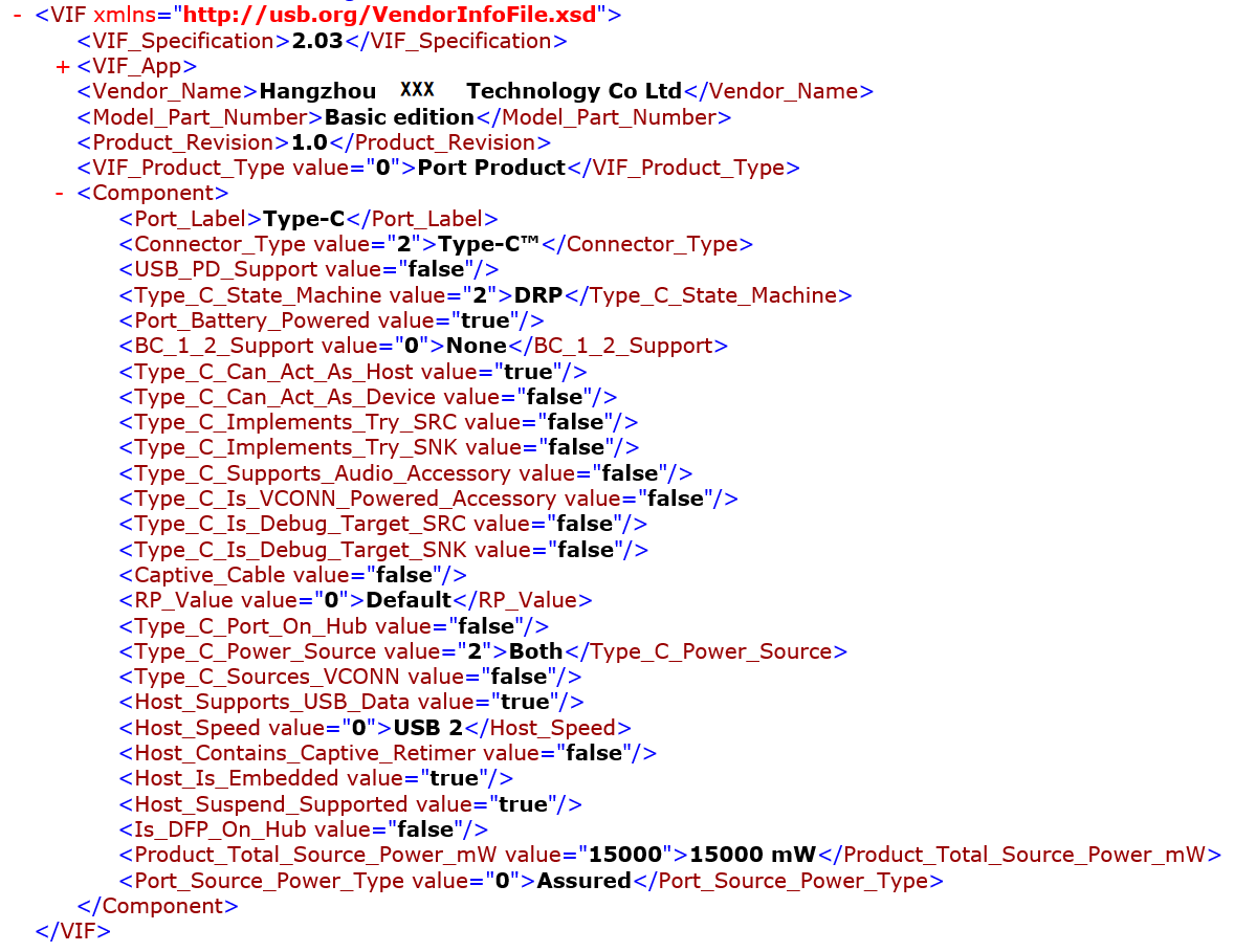

We use TUSB320HAI for testing with USB compliance testing, and have resolved 3 errors : TD 4.5.6, TD4.8.2, TD4.10.1. But the error of TD4.5.4 still exists .
Thanks and best regards
Your VIF should reflect the Type-C versions you are testing this should limit certain test that are not covered by older versions of the Type-C specification. If the VIF is not updated the you may see failures. (VIF_Specification)

Sorry for the delayed response, I am still looking into possible causes for this issue and hope you get back to your by the end of today. Do you have a log you could share by chance?
Thanks for letting me know and I am glad that the issue was resolved. Could you share how the issue was resolved for others on the forum?
The cause of this question is influence of circuit parameters of VBUS, especially the capacitor. the capacitance of the filter capacitor is large and VBUS voltage changes slowly. Of course, firmware is also important.
