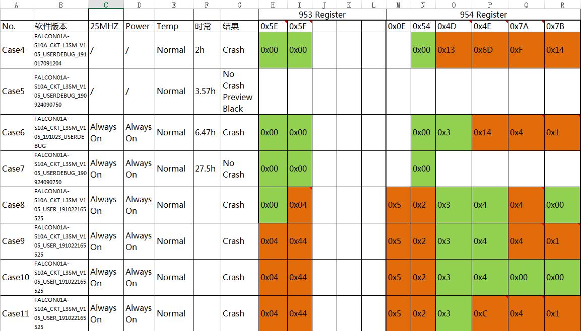

register 0x4D 0x4E 0x7A 0x7B ,Normal Value is 00;
The value changes to 0x4D=0x13; 0x4E=0x6D; 0x7A=0xF or 0x4; 0x7B=0x14 or 0x1 in case of error.
Please tell me where the problem is? Whether 953 coding is abnormal?
    0x4D = 0x13; Lock status changed but system is locked to input and Pass bit is high.
    0x4E = 0x6D; Line length changed, FPD3 encoder error, CSI error, freq is stable and line count changed.
    0x7A = 0xF or 0x4; Different CSI errors
    0x7B = 0x14 or 0x1. CSI error count

    Today, a crash occurs in the customer test. The latest abnormal register values are as follows.
    Please help to analyze the reasons.
    I have a summary.
    953 Register
    0x5E = 0x04( should be 0x00)
    0x5F = 0x44( should be 0x00)
    954 Register
    0x0E = 0x5( should be 0x4);GPIO_PIN_STS
    0x4D = 0x3( should be 0x3) ; RX_PORT_STS1;Lock status changed but system is locked to input and Pass bit is high.
    0x4E = 0xC( should be 0x4); RX_PORT_STS2 ;Line length changed, FPD3 encoder error, CSI error, freq is stable and line count changed.
    0x54 = 0x2( should be 0x0)  SENSOR_STS_3
    0x7A = 0x4 ( should be 0x0)  CSI_RX_STS
    0x7B = 0x1 ( should be 0x0)  CSI error count.
  • Hello Mandeep Singh
    I have a statistical table and Log file named  Case 11.
    CrashLog_Case11.rar
