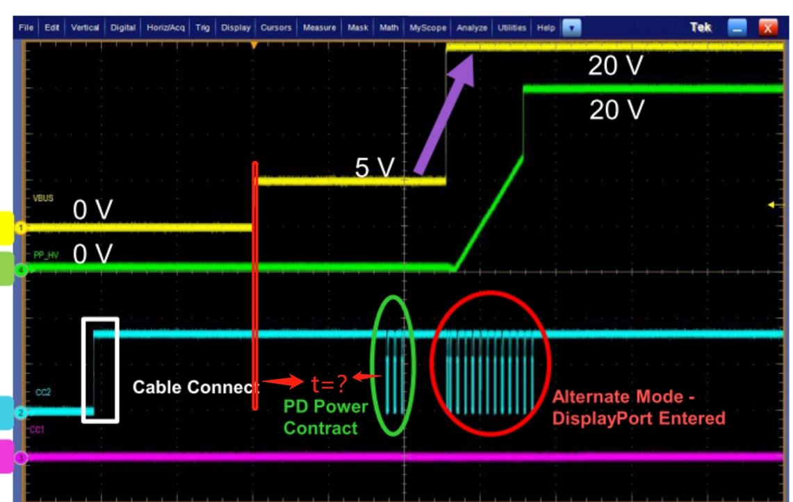

Q7, What is the T value as below?
Hugo

    7. I'm not sure which time interval you are referring to, however, you can reference section 6 of the datasheet for the provided timing values here: https://www.ti.com/lit/ds/symlink/tps65987d.pdf
