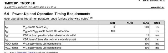

Customer is using TMDS181. however, their sequence timing is different.
Is there any concern for the td1 is 370us? longer should be better?

Hi Team,

As long as OE goes high with minimum of 100us after VCC/VDD is stable, then there is no timing requirement between VCC and VDD.
