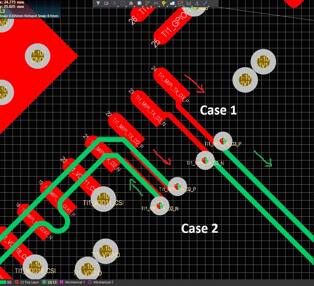

please can you tell your opinion or provide a app-note that tells what is the difference between two routing cases:
Case1 : the diff signal goes from pins 24/23 on top layer and switched to layer L3 with blind via and maintains the direction
Case2:  the diff signal goes from pins 21/222 on top layer and switched to layer L3 with blind via and revers ( makes a 180° turn bend?) the direction
How much more bad is the case2 to case1 in terms of signal integrity?
D.

    It is the same either way.  Since you are going from Layer1 to Layer3, the reference plane is the same for the "red" and "green" signals so no return current vias are needed.
    Lee

    But my question was regarding a turn bend , lets illustrate this in 3D
    a) When between L1 and L3 is GND then the 180°turn in Case 2 is not a problem?
    b) what if we don't have three layers, only two and Case2  then and input signal is on L1 and output signal is on L2, will then this 180°turn represent a bad angle for routing?
  • Hi Lee,
    We've done this in the past and haven't seen any issues in either case. My only recommendation would be to add a GND via next to the high speed via to help control the signal/gnd signal integrity.
    Mandeep Singh
