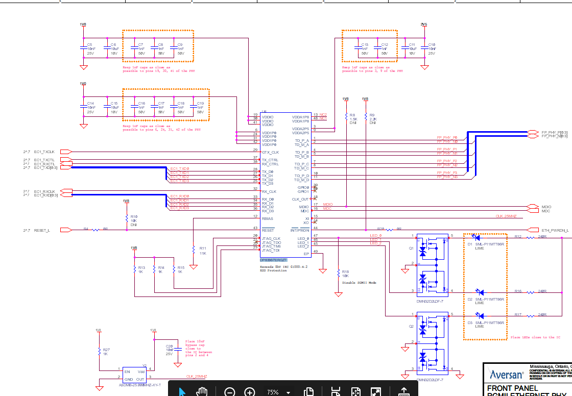

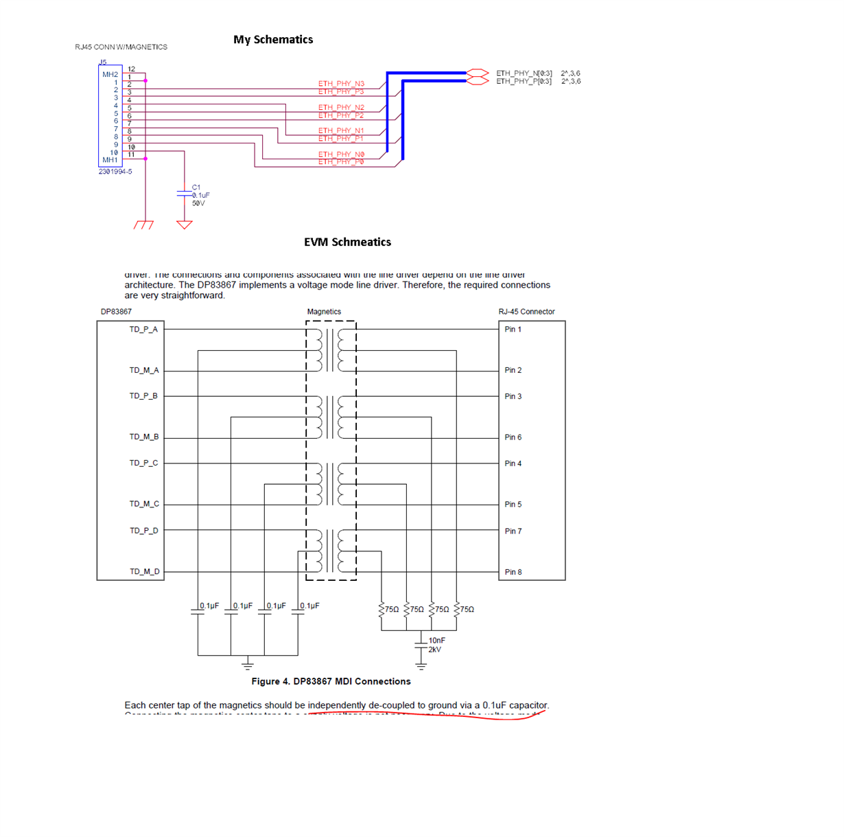

We have the DP83867ERGZT in RGMII mode to the MAC.
We are having intermittent issues in loosing packets/pings from link partner to the MAC.
The link partner sends it out (wire shark sees it) but MAC never receives it in uboot or linux
We probed the TXclk & Rx clock @125Mhz.
TX0,1,2,3 toggle.
RXD,1,,2,3 toggle.
Far end loop back-works consistent
Analog Loop back works consistent
When we do pings of 32 bytes size or more we see packets not reaching the MAC.
RXD0 resembles clock
Link Speed 1gbps
Power sequence /power supply- we are confident but ye to check.
Questions:
1. Is it okay RXD0 to resemble clock?
2. do you know if we have a MII decoder in the market?
3. is there an errata sheet for this phy?
