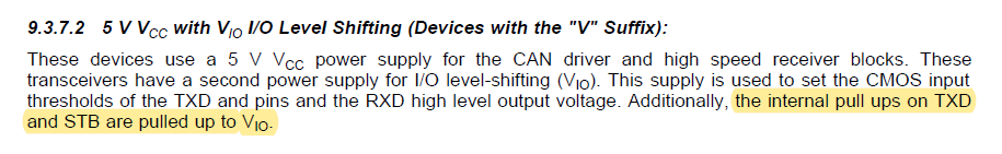

TCAN1042-Q1: the pull up impedance of STB pin
Part Number: TCAN1042-Q1
Hi
would you mind to provide the pull up impedance of STB pin?
TKS!
    The strength of the internal pull-up is documented as the low-level input leakage current.  The maximum value at VIO = 5.5 V is 20 uA, so you could consider the minimum equivalent resistance as (5.5 V) / (20 uA) = 275 kOhm.  Note that this is a fairly "weak" value and so you may wish to also include an external pull-up if needed (for example, if the external leakage currents on this node due to PCB/MCU pin leakage/etc. are more than a few uA).
    Please let me know if this isn't clear or if you have further questions.
