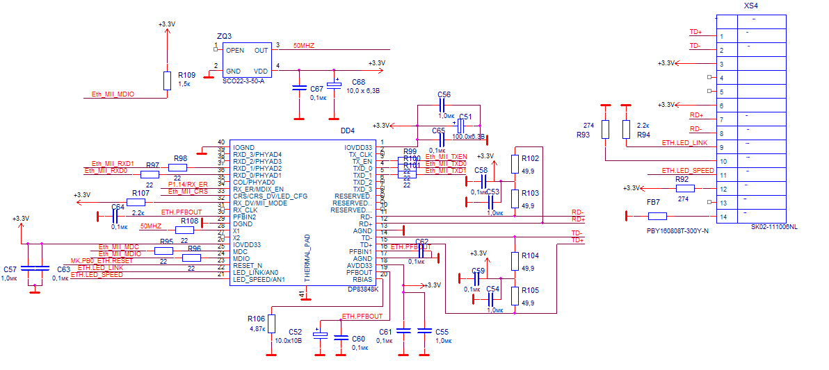

I made a circuit based on STM32 and DP83848K. ALL according to the description. In the code in the Ethernet settings indicated auto-negotiation. I connect to the PC. In the network settings I indicate 100MBitps, there are pings. If I change the settings to 10Mbitps, there are no answers to ping. What could be the problem?

    on STM32 I use HAL and set Init.AutoNegotiation = ETH_AUTONEGOTIATION_ENABLE in the Ethernet settings
    I change the transfer rate on the PC. after changing the settings I reboot the device according to the power - the problem persists. When I set 10Mbps, ping is absent, when I change to 100 - ping appears.
    My schem is right?
    Andrey

    Please compare your schematic to: https://www.ti.com/lit/df/snlr011a/snlr011a.pdf
    On a quick look it looks like your AN1 and AN0 straps are not set to support 10BASE-T. Please refer to the strap options section. I believe you need to pull up both these pins with 2.2k resistors to advertise 10BASE-T as well as 100BASE-TX.

  • As a result, it turned out that if the settings in the firmware are the same as on the PC, then 100 Mbitps and 10 Mbitps work.
    If you specify ETH_AUTONEGOTIATION_ENABLE in the firmware,  and specify a specific speed on the PC, it only works at 100MBitps.
    About AN1 and AN0 - as I understand it, this is the initial configuration of the chip, which can be changed by the settings in the registers.
    Vibh, thanks for the help!
  • Hello Andrey,
    Glad to hear that both speeds work now. I will close this ticket now.
    Your understanding is correct regardless of the straps you can use register configuration after the initial strap configurations.
