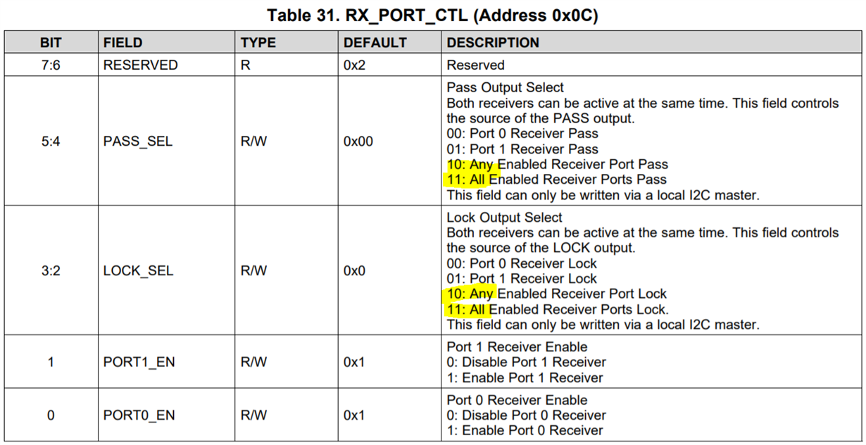

In register 0x0C of the 936 datasheet, for PASS_SEL and LOCK_SEL, there is an option of 10 for "Any" and 11 for "All" Enable Receiver Port(s) Pass/Lock. What is the difference between those two? I am not clear under what condition I would select 10 vs 11.
Any insight you can provide would be greatly appreciated. Thanks!
