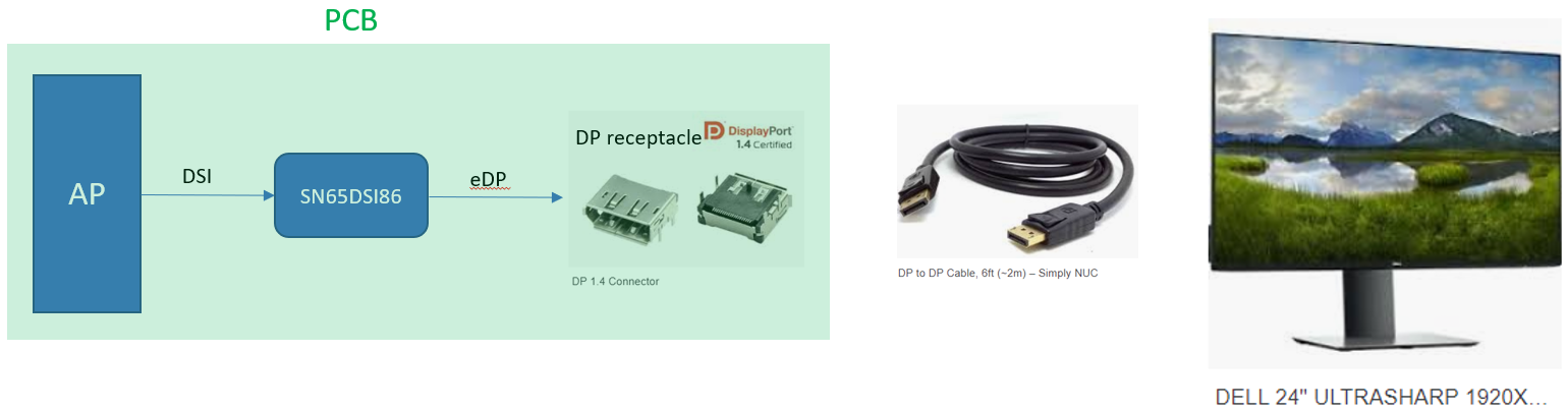

Hi sir
In datasheet 9.1 application,
Because SN65DSI86 does not support HDCP, we can't use for external DP monitor?
BR
Ethan
Ethan
The SN65DSI86 can do MIPI to DP, but the DSI86 does not support audio over DP and does not support HDCP encryption.
David
Ethan
DSI86 can support standard DP monitor as long as neither of below is true:
If neither is required, then they can use DSI86 with a standard DP monitor. Make sure TEST2 pin is pulled high (1.8V) and follow sequence in datasheet to disable ASSR.
Please check if #1 and #2 are required by the monitor.
