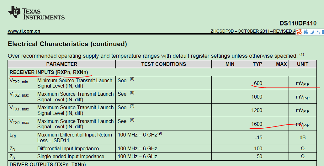

DS110DF410: we want to check the risks if the min of RX peak-peak is only 510mv
Part Number: DS110DF410
Hi team,
we want to check the risks if the min of RX peak-peak is only 510mv. The typical is 600mv. Thanks.
    The minimum value of 600mVppd listed on the datasheet assumes input channel as per "Note 6"Differential signal amplitude at the transmitter output providing < 1x10-12 bit error rate. Measured at 10.3125 Gbps with a PRBS-31 datapattern. Input transmission channel is 40-inch long FR-4 stripline, 4-mil trace width." If a low loss to medium loss input channel is used then applying 510mVppd at the input channel should not involve any risk.
