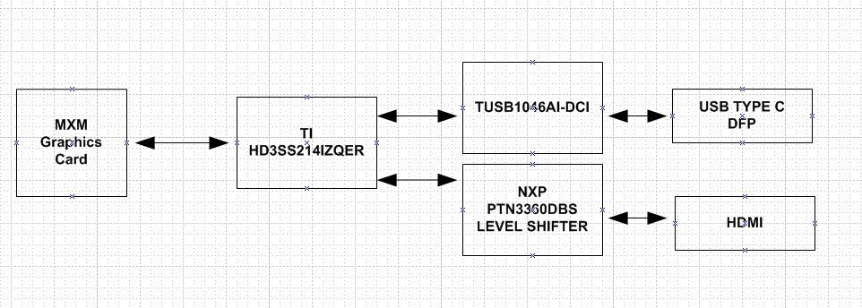

please refer to the figure below.
I am connecting HD3SS214IZQER as a 1:2 display port demux to switch my MXM module display port lanes either to USB type C circuit or a test HDMI connector.

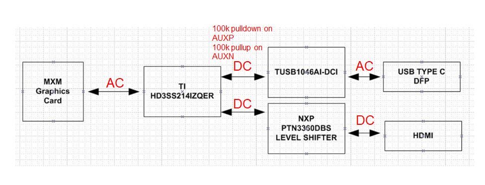

HD3SS214IZQER datasheet section 7.1 has a note stating there is no common mode biasing. I want to make sure I got the decoupling caps right with respect to DP lanes. Port C of HD3SS214IZQER connects to the MXM module via decoupling capacitors. Port A connects directly (no caps) to TUSB1046AI-DCI USB type C/DP switch. Port B directly (no caps) connects to HDMI level shifter NXP PTN3360DBS which connects to the HDMI connector. Is his okay for the 4 differential lanes and AUX lanes?
AUXP/AUXN channels of port B are pulled up close to the HDMI level translator to 3.3V and AUXP connects to SCL while AUXN to SDA. Is this correct?
Can I pull down DDC channels on ports A/B/C of HD3SS214IZQER since I am not using it?
HD3SS214IZQER table 1 says I must make AUX_SEL:DxSEL as 00 or 01 to switch port C to port A or port B. However section 8.2.3.2 says it differently where AUX_SEL is used to switch the AUX lines between A to C or B to C. Which is right?
