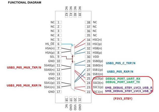

Hi Sir,
Does HD3SS6126 can support MUX feature as below diagram? Switch for USB3.0 TX/RX or UART/SMBus SCL/SDA?
Here is the UART/SMbus I/O voltage range and data rate information.
UART data rate: 115.2KHz
UART signal voltage range of the I/O: 0V~3.3V
SMBus data rate up to 100KHz

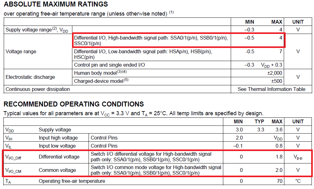

I checked the datasheet as below, HD3SS6126 may not be able to support it due to the UART I/O voltage range is out of "Recommand operation range".
Is it correct?
Is so, do you have any suggestion solution for USB3.0 TX/RX or UART/SMBus SCL/SDA switch?
