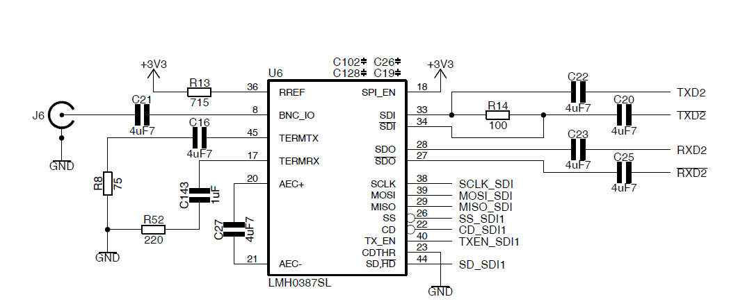

    1). I believe you have already confirmed HD/3G cable driver works. This means TERMtx pin#45, Rref pin#36, TX_EN pin40, and other cable driver related pins are connected. Even if you did not have SD/HD pin set correctly your slew rate would have been incorrect.  I am assuming you see this issue on all devices ?
    2). Do you happen to have  access to a BERT? Is it possible if you can use this BERT and run at HD/3G which we know works. Once HD/3G works then on BERT switch only the data rate to 270M. I expect this to work since cable driver does not have intelligence - other than SD/HD to set slew rate properly - to determine whether this is SD or HD.
    Regards,, Nasser
  • Hi Nasser,
    1) Yes, I have 2 LMHs and the issue is always present.
    2) I have not acess to a BERT.
    I send you the connection schematic. I already change C27 with a 1uF capacitor.
    TX_EN = '1'
    SD/HD = '1'
    register x"00" <- value x"10" (force equalizer sleep).
    I used an Intel'IP on my FPGA that should generate SD_SDI signal. It uses a 148.5 MHz clock signal as reference  and 1 pixel (Y-Cb/Cr) last 11 clock cycles (13.5 * 11 = 148.5 MHz). It  uses a data_valid signal at 27 MHz to sample Y and Cb, Cr.
    I wanted to be sure that is not an hardware problem and that I set properly LMH device as SDI-SD transmitter.
    Bryan
  • Hi Bryan,
    Given HD/3G cable driver works, i don't see a reason why SD should not not work. Your hardware looks fine to me. I compared regular evaluation board schematic.
    Regards,, Nasser
