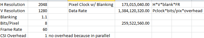

I'm trying to understand how to handle YUV422(8-bit) imager data when using a DS90UB935-Q1.
YUV422 is 16 bits/pixel and the 934 is only a 12bit parallel interface.
I'm guessing you need to split each pixel so it is sent in two cycles (maybe an 8bit and 8bit or a 12bit and 4bit)?
1. Am I'm correct and splitting the pixels is the best way to do this?
Here are the system requirements:
- H Resolution: 2048
- V Resolution: 1280
- Bits/Pixel: 16
- Frame Rate: 30
- Paired Seralizer: 935
2. What is the best way to calculate the PCLCK and data rate for this? Do I assume just twice the Framerate (60 instead of 30):
3. Is there a way to make this work for the 935 which has a max data rate of 1.87Gbps and max PCLK of 100MHz?
Thanks for the help!
