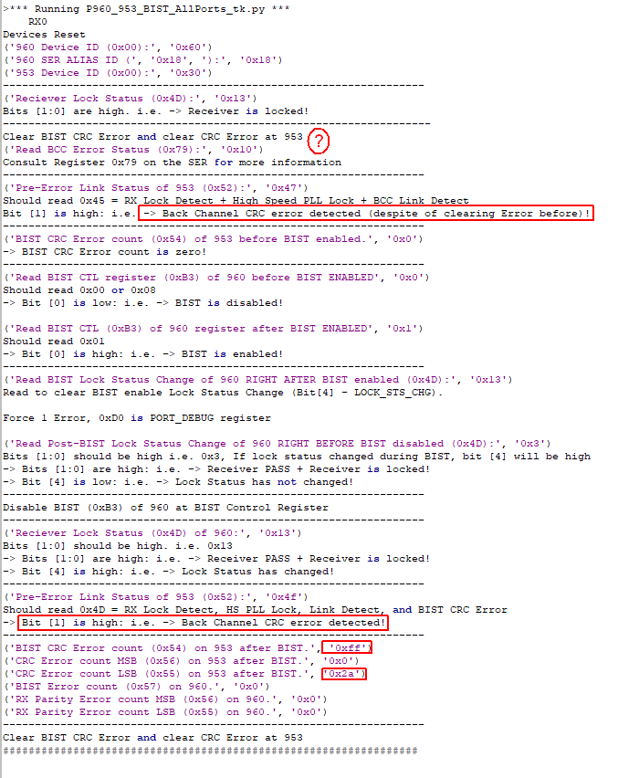

  • Hi Thomas,
    Glad to hear the pattern generator on the 960 is working well.  Before we hop over to the pattern generator on the 953 and test it over the link, lets first test the link.
    Please let me know what the results are from running this script: P960_953_BIST_AllPorts.py
    It is found in: Analog LaunchPAD v1.57.0010\PreDefScripts\DS90UB960
    Please copy and paste the results from the terminal after the script is run.  It utilizes the BIST with descriptive output.  If everything checks out, our next step will be to try the pattern generator.

  • Hi Bryan, thanks for your Help.
    I have excecute the script, and the Output was:
    >*** Running P960_953_BIST_AllPorts.py ***
      RX0
    Devices Reset
    ('960 Device ID (0x00):', '0x0')
    ('953 Device ID (0x00):', '0x0')
    ('Reciever Lock Status (0x4D):', '0x0')
    Bit [1:0] should be high. i.e. 0x13
    ('Read BCC Error Status (0x79):', '0x0')
    Consult Register 0x79 on the SER for more information
    ('Pre-Error Link Status of 953 (0x52):', '0x0')
    Should read 0x45 = RX Lock Detect, HS PLL Lock, Link Detect
    ('BIST CRC Error count (0x54) on 953 before BIST.', '0x0')
    ('Read BIST CTL register (0xB3) Before BIST ENABlED', '0x0')
    Should read 0x00 or 0x08
    ('Read BIST CTL (0xB3) register After BIST ENABLED', '0x0')
    Should read 0x01
    ('Read BIST Lock Status Change of 960 RIGHT AFTER BIST enabled (0x4D):', '0x0')
    Read to clear BIST enable Lock Status Change.
    ('Read Post-BIST Lock Status Change of 960 RIGHT BEFORE BIST disabled (0x4D):', '0x0')
    bits [1:0] should be high i.e. 0x3, If lock status changed during BIST, bit [4] will be high
    Bits [1:0] should be high. i.e. 0x13
    Should read 0x4D = RX Lock Detect, HS PLL Lock, Link Detect, and BIST CRC Error
    ('BIST CRC Error count (0x54) on 953 after BIST.', '0x0')
    ('Parity Error count MSB (0x56) on 960.', '0x0')
    ('Parity Error count LSB (0x55) on 960.', '0x0')
      RX1
    Devices Reset
    Should read 0x01
      RX2
    Devices Reset

  • Hi Bryan,
    meanwhile we adapted the 960_953_BIST script to our conditions.
    We got following result:
    There is still the question concerning reg. 0x79 of 953.
    Then there is always a BC error in communication and what is the explanation of the errors in last section?
    Sincerely
    Torsten

  • Hi Torsten,
    Thank you for running the script.
    The errors may indicate intermittent lock conditions.
    Please poll register 0x4D every second for a few minutes to test the change of state of the register.   Looking to see if we catch frequent state changes and/or unlocked state.
    If frequent state changes are seen, please describe your setup and connections between more devices in detail.  For example, are these custom boards or evms, what cables are being used, etc...
    There is also a MAP tool that may be used to investigate the link conditions of the forward channel.
    Sincerely,
    Bryan Kahler
  • Hi Bryan,
    thanks for your hints.
    I added polling of reg. 0x4D to the script. Even increasing to 200 measurements (one per second) did not yield a single Lock Status Change.
    The other results are relatively reliable and stable.
    The information concerning reg. 0x79 of SER is still missing.
    Our system is based on a self designed ECU (TDA based) with 960 DES and a self designed camera (with 953 SER), working in CSI-2 mode.
    Data are transmitted via TP on a DACAR 535. For BIST DES and SER are powered up with default register settings.
    PS: Is it possible to start a BIST in DVP mode too?
    Torsten
  • Hi Torsten,
    It appears there was a lock drop during BIST.  Please run the margin analysis and share the results.  Also, is a POC network being used?  If so, please share your schematic including the POC network.
    Sincerely,
    Bryan Kahler
  • Hi Bryan,
    attached you will find passed margin analysis. It seems to be reliable.
    We do not use POC. SER is connected via TP, i.e. there is a separate power supply for SER.
    Torsten
