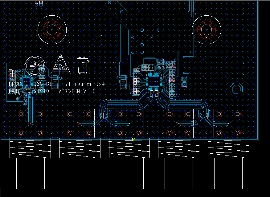

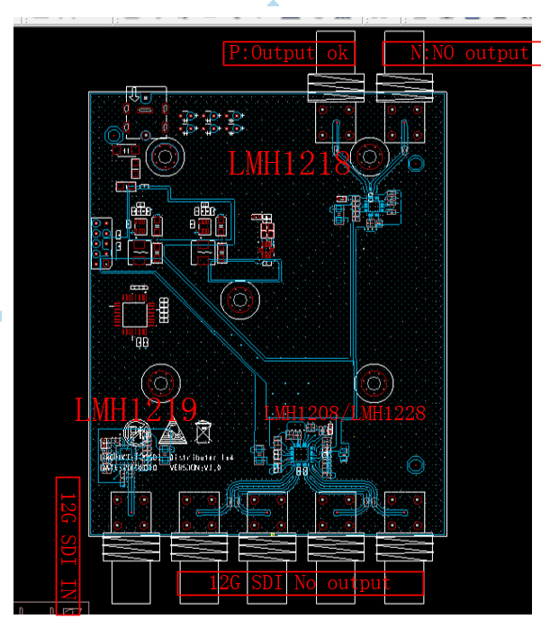

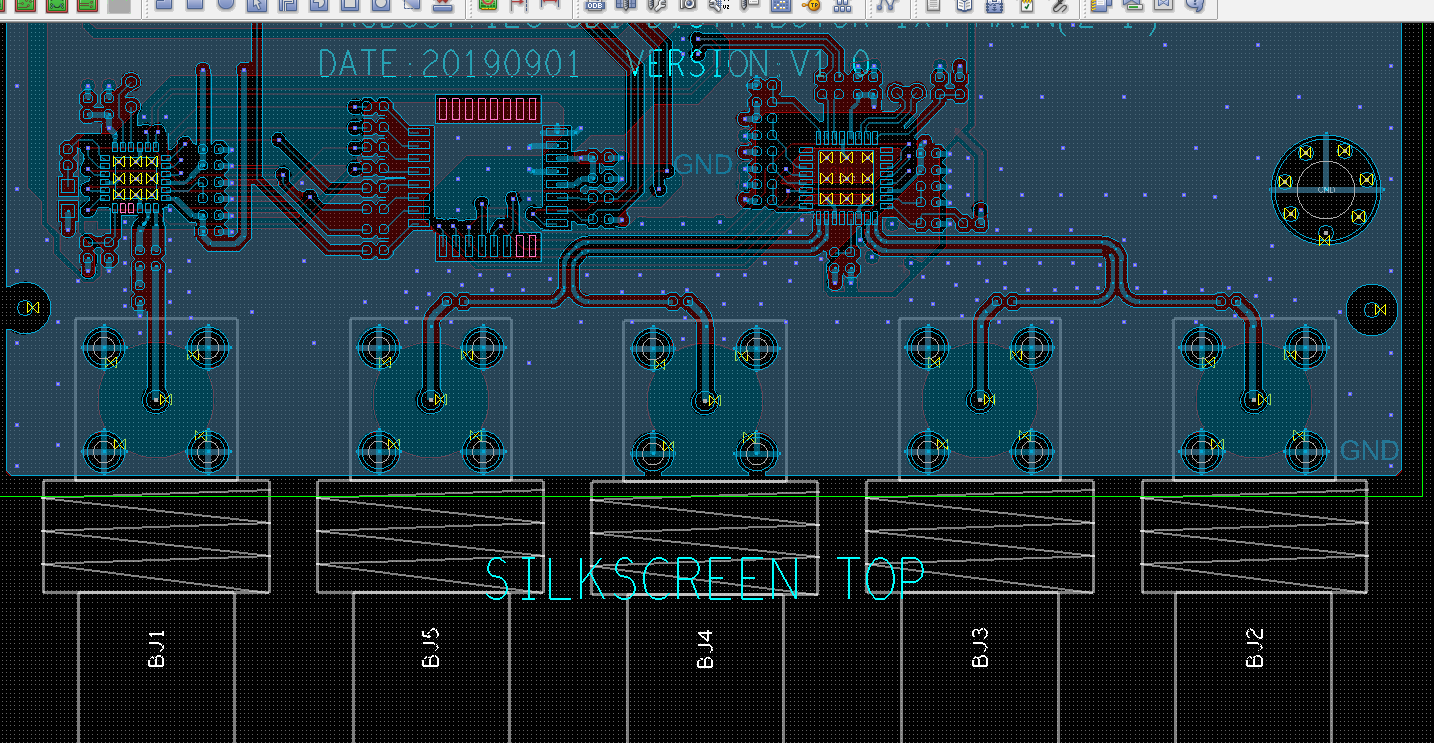

- Our design is lmh1219 + lmh1208, which requires one 12g-sdi input and four 12g-sdi outputs
- Now we have designed two versions, but none of them are correct. The version1.1,the LMH1208 sdi_out1± and sdi_out2± Neither output(12G-SDI);The version1.2,the LMH1208 sdi_out1+and sdi_out2+ both output(12G-SDI),But SDI-OUT1- and SDI-OUT2- must connect GND (75R),Fail to meet the requirements of 4 output signals。The version1.1 and version1.2 right for 6G-SDI,(ALL)
- The SLEW_CYRL and VOD IO / registor is setting 12G rate. LOCK_N PIN and lock registor display ok ,I have read the register information.

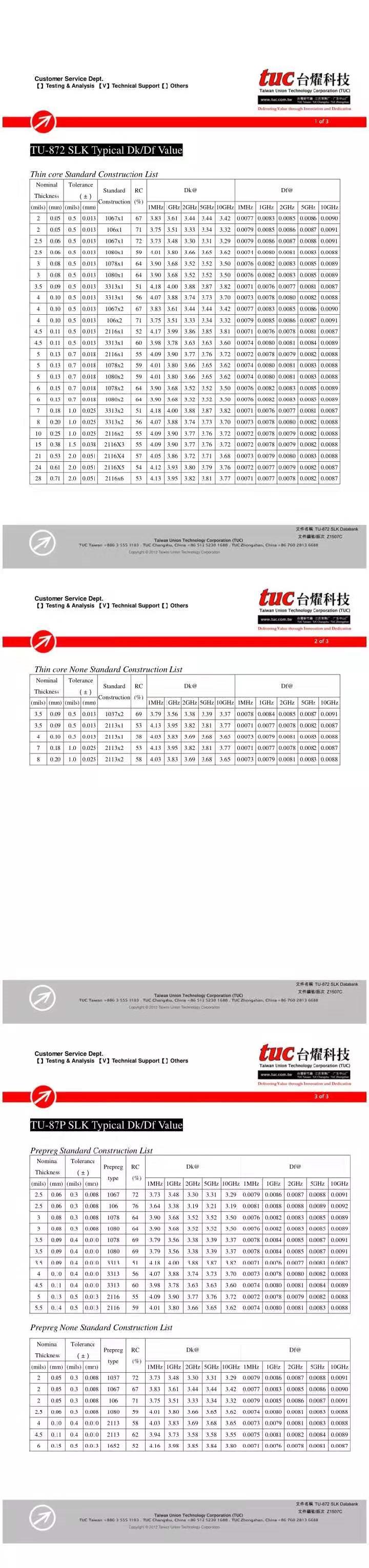

- Question : What are the LMH1208 requirements for industrial PCB ; S1000 ,TU872SLK(SP),TU883(T2) ?
- If the following PCB supports,What else should we pay attention to?
