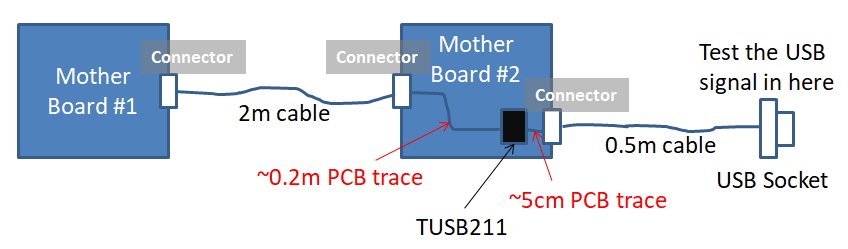

Hi Experts,
Our customer currently is using TUSB211 as the USB2.0 signal redriver in below block diagram showing. After their test, they found there is no obviously changes for the D+/D- eye diagram, even changed the different EQ level. Can you help to suggest what is the recommended location for TUSB211 in below customer's use case? What's the possible reason for TUSB211 no effects in such application?
