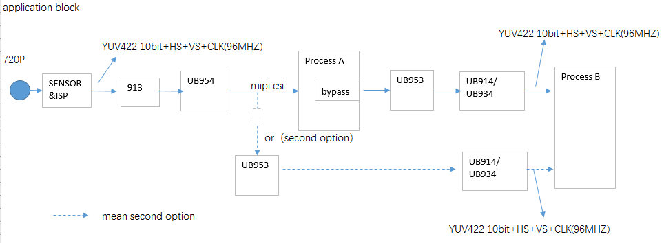

in our system,there are two processors, one named A with MIPI-CSI2 TX and MIPI-CSI2 RX interface, the other processor named B is parallel interface input.
A camera is connected to processor A via mipi csi2 RX interface ,camera image format is YUV422 10bit+HS+VS clk=96mhz
processor A can also bypass output the camera image via mipi csi2 TX interface
processor B want to receive the bypass output image from mipi csi2 TX interface of processor A
processor A bypass output with DS90UB953 as serializer, processor B with DS90UB934 as deserializer

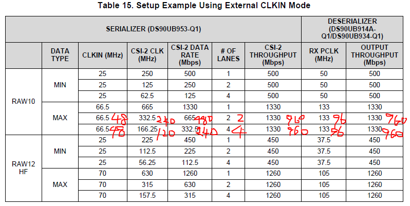

from snla270a.pdf ,we know we need to calculate date rate ,
in snla270a.PDF, table15(setup example using external clkin mode)
but I do not know the meaning of RX PCLK from table15,I know there is a PCLK Singal in UB934,
can you tell me what is the difference between PCLK and RX PCLK
in UB913 Datasheet,there are two sentences,
one is 10-bit payload up to 100mhz,the other is 12-bit payload up to 75mhz,
100mhz/75mhz means RX PCLK or means PCLK?
there is a note in snla270a.pdf as below
It is important that the sensor be synced to the external clock (either
directly or by the DS90UB953-Q1 CLKOUT), because a variation or drift in CSI-2 data could cause buffer overflows.
but in our system, DS90UB953-Q1 CLKOUT cannot be connected to processor A
how to use the DS90UB953-Q1 CLKOUT
Are there any problems if we donot use DS90UB953-Q1 CLKOUT?
