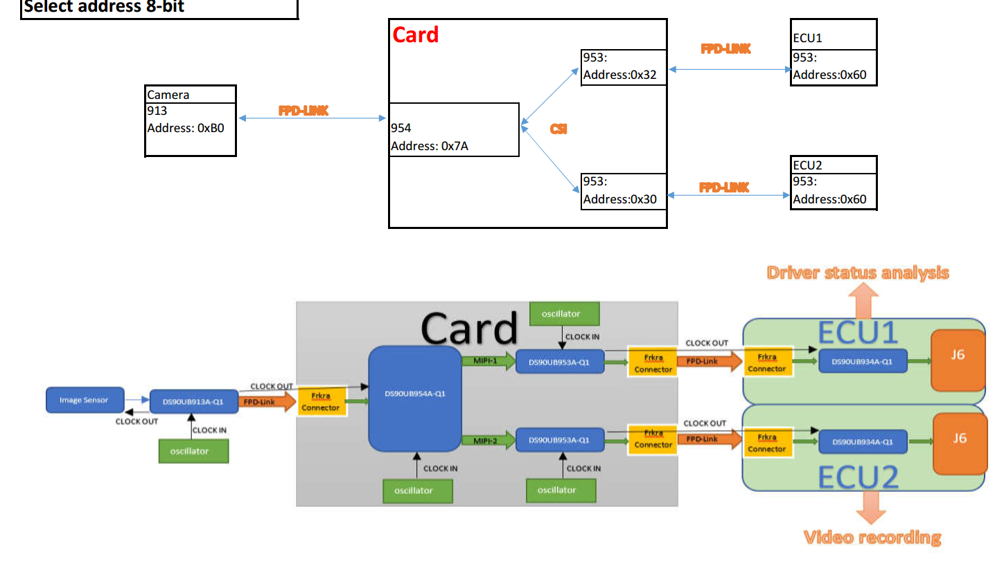

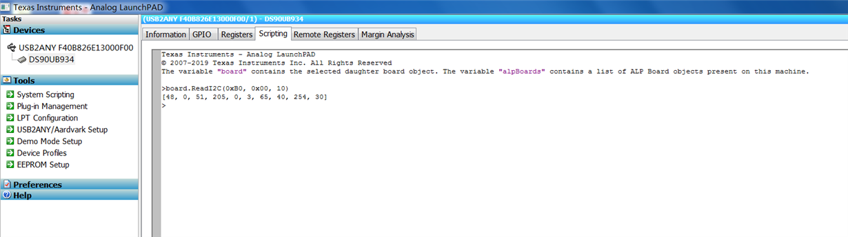

we are building a card to switch the image from camera. You can see the block diagram in attachment. Now we meet a problem, when we want visit 0xB0 of 913 in camera side from 934 in ECU side,   you can see the pic,we actually get the 0x30 as a response. that is not the 913 address. I think maybe some registers has not been ready. would you help to check it? I have enable I2C througout of every deserializer and Serializer.switch board.pdf
