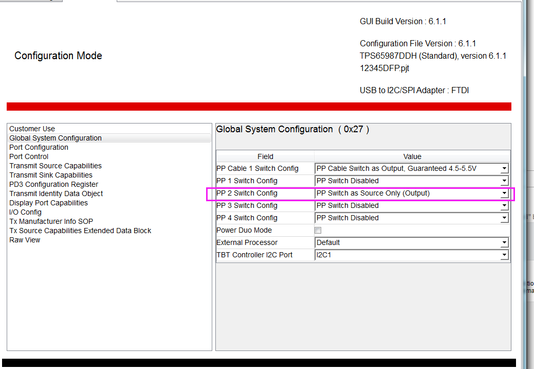

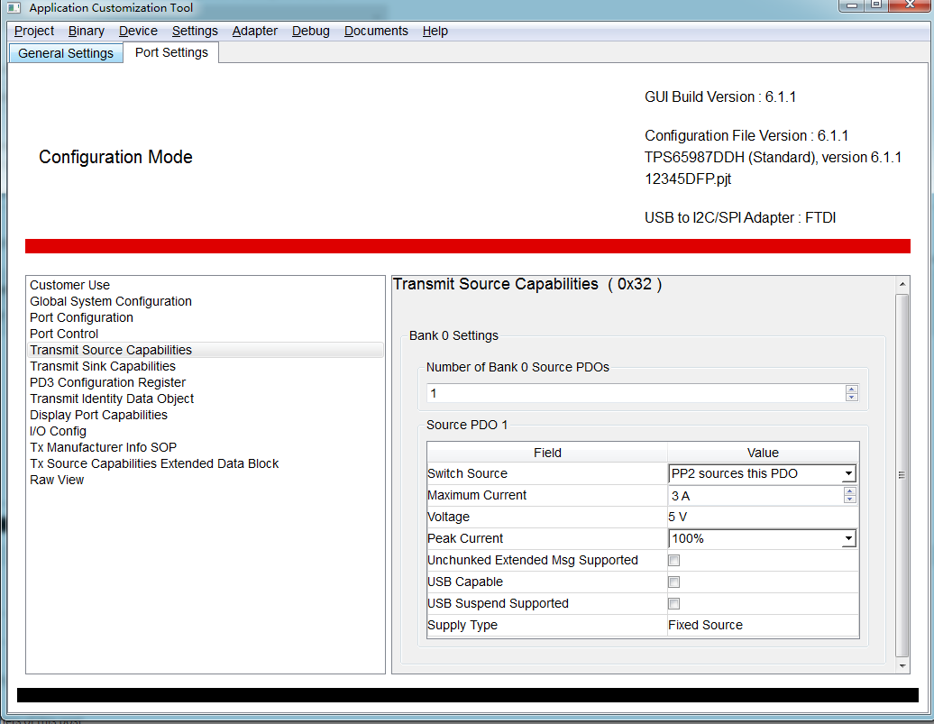

Hi :
We first made the TYPE-C solution, and now it is found that the PP-HV2 of the TPS65987D pulls the power supply 5V( Aways power )low at power-on.Is the software setting problem causing chip protection? Please help check if our software configuration is OK?The application of our TYPE-C is mainly the switching of USB/DP signals. In DP mode, it needs to output 5V power for DP monitor.Attachment is schematic and PP HV configuration table.5050.USB-C1.pdf
