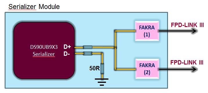

Hi Sir,
If DS90UB9x3 can have 2*FAKRA output at the same time?
Or we have others solution?
Thanks, Ian.

Ian,
Sorry, 9x3 can't support this application. Now we have no existing solution to support dual FPD-Link channel in camera side.
best regards,
Steven
Thanks Steven, looks competitor have this solution.
The application will be Car using DMC and facial recognition.
Thanks, Ian.
Ian,
please give me email, we need if the solution is reliable or not. as you know, if both diff. pins are used to transmit the high speed signal to different de-ser, it is not a good solution due to reliable design.
