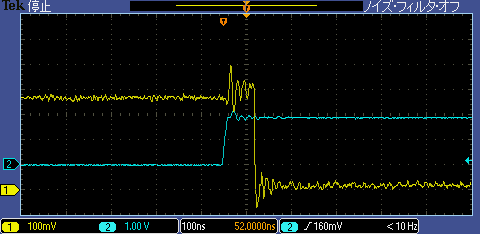

  • Hi Vibhu,
     The reset and power-up timing are OK on the custom board.
     I checked DP83867IRPAP-EVM using waveform generator for reset signal  and got the wave of reset rising and RX_D2 as follows:
    Blue:RESET, Yellow:RX_D2. Reset sloop is 5nsec.
    RX_D2 has an amplitude of 100mV or more at reset, which seems to affect the strap voltage.
    Is there any problems with this waveform?
    Does a capacitor need to be connected to RESET to solve this problem?
    Kenshow
  • Hello Kenshow,
    Please try reconnecting C6 this should smooth out the ringing. Let me know if that doesn't work.
    Vibhu

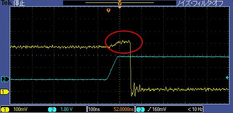

    EVM with a slope for RESET release has the following waveform.
    RX_D0 on EVM has a similar waveform. In this case, the register value is considered normal from the result of the custom board.
    From the waveform in EVM, We suspect that Rx_D2 of the custom board may be affected by the MAC side or layout, too.
    Then, I have a question:
    The voltage of RX_D0 and RX_D2 rises a little when reset is released on EVM. Is this a specification of the PHY device?
    Kenshow
  • Hello Kenshow,
    Please contact your FAE for a MSP launchpad to read the register voltages. After reading the registers you will be able to determine if the PHY has entered the right mode and the strap settings were accurate.
    To answer your question this rise in voltage that you see is not a specification of the PHY device. After reset the voltages are sampled before the PHY goes into a certain mode.
    Vibhu
  • Hi Vibhu,
    Thank you for your reply.
    I agree that the voltage is sampled after the reset is released and before the PHY enters a specific mode.
    Apart from this problem, I would like to know if the waveform in my previous post is normal as DP83867. If your answer is "No", please check your EVM.
    Kenshow
  • Hello Kenshow,
    Unfortunately I cannot tell you what is "normal" because this is not characterized.
    If you see this behavior and read your registers and PHY enters the correct state, then there is no issue.
    Vibhu
