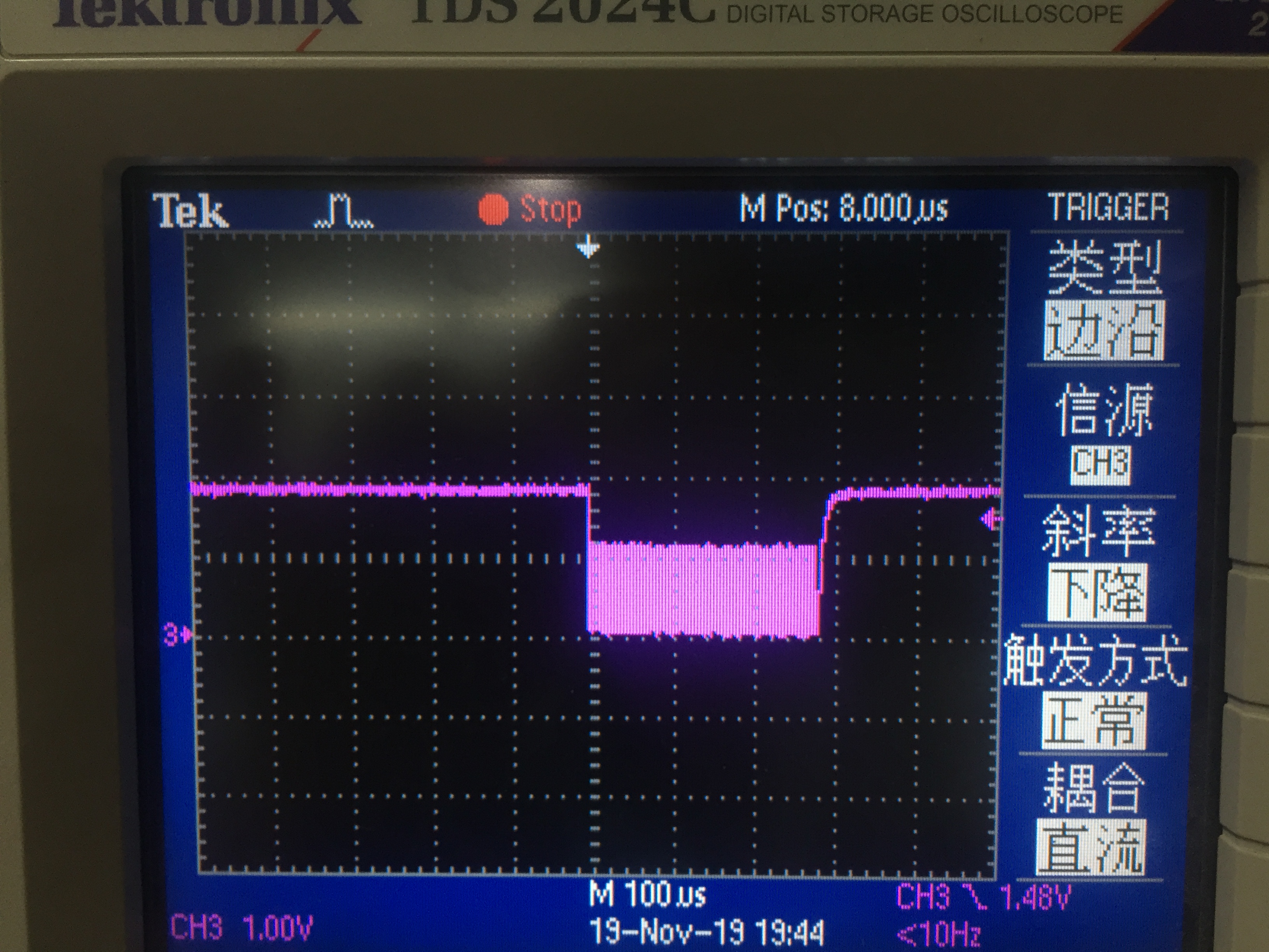

  • Hi Hari:
        I have found out why Vbus does not have Power, but according to the firmware of the accessory I provided, insert the TYPE-C HUB,  When the device is plugged in, the waveform of the CC is attached, but when I connect to the USB3.0 device or the DP display, the measured signal is as POL=H EN=L AMSEL=L.,display did not shown.

  • Hi Hari:
        I tried the firmware provided and found that neither USB3.0 nor DP can be used.I checked the firmware configuration you provided and found that the GPIO configuration did not match my schematic ,I modified it myself but still can't.Is it related to communication recognized by CC? We use TYPE-C HUB to access the test function and Windows shows that Displayport connection may not work properly, please try other cables,but i test the POL=L EN=L AMSEL=L.When I pull up 3.3V on POL EN and AMSEL, it is H level after entering the system, it seems that the GPIO is not controlled.

  • Hi Hari:
       Our schematic as attached, the layout is based on the datasheet layout guide. I pull EN and pull down POL and AMSEL according to the table of HD3ss460, so that you can find USB3.0 devices, so the problem point is still firmware and chip. Why accessing 3.0 devices or DP devices, GPIO has no action,the rom we use the winbond w25x10cl,Please help check,I found TPS65982+HD3SS460 GPIO configration as below,so GPIO configration is ok?Can you provide a link to a detailed description of the event .Thanks!
    3056.1119 USB-C1.pdf
    I noticed that you don't have the GPIO events configured for some of the HD3SS460 Control Pins and therefore the GPIO won't trigger any actions. I would recommend taking a look at Section 3.2 of the DisplayPort Alternate Mode Application Note for configuring this as it shows an example of the GPIO Event Map Register in figure 4. I think this should resolve the issue if the IC isn't damaged.
