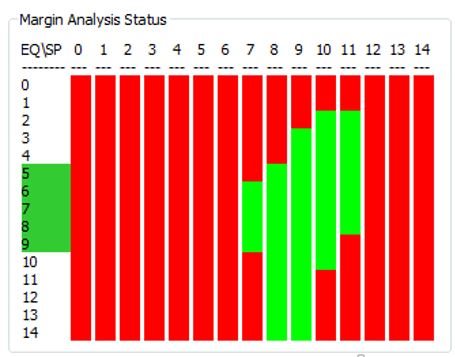

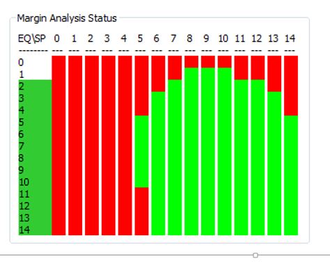

  • Hi Jiashow,
    Thanks for the reply.  The MAP output for the twisted pair link for which I am seeing the problem is shown
    The typical output for a cable which causes no issues is shown
    Paul
  • Hi Paul,
    The margin looks good. Are you able to get consistent link but just not PASS? How are you setting your PASS criteria?
    Jiashow
