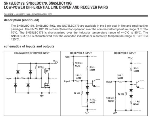

Could you share the ESD protection circuit of "THVD1452"?
My customer requested to provide such like below information.
Shidara
Shidara,
The equivalent schematics of THVD1452 is attached.
Please let me know if you have more questions about the device.
