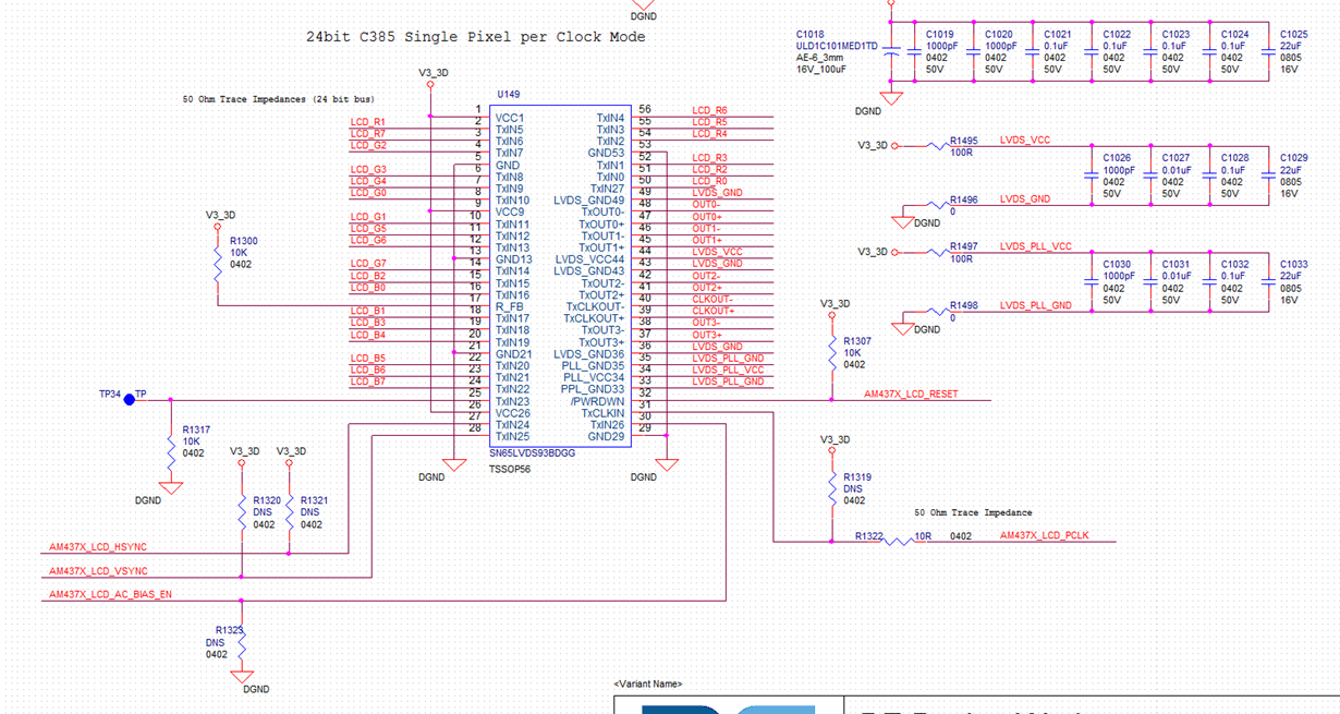

We're testing this chip now & having issues. We can test the exact same board & all other components, cable, etc side by side with the original part, DS90C385AMTX... We get a crystal clear screen with DS90 part, junk with SN65LVDS93B. We have tried multiple boards with the SN65 part.
In addition, is the operating temperature of the chip dependent on the rate of the pixel clock? For example, if we are running at clock rate of 6,800,000, would this allow us to run the chip in an 85C temperature environment?
