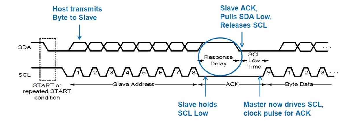

Following is the block diagram for our project. In this, I have to communicate the SDF on Camera Head Sensor. For that, I have to configure Deserializer,Serializer and then I2C on the Camera Head sensor.
For me, now communication is happening between Deserializer & Serializer. But after all configuration of both, I could not communicate with any of the remote slave device( EEPROM(ID-0x50), GPIO Expander(0x20), PMIC(0x28), I2C-SPI bridge(0x3D) inside the FPGA etc in this case).
I am attaching the register settings for Deserializer and Serializer. Please let me know if any other things i have to consider.
