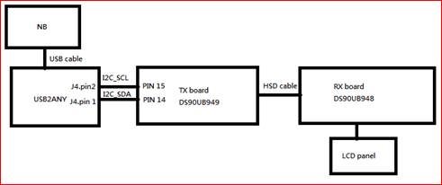

Here are the HW setup as below.
Mode_sel0 = 1.275V
LCD panel show the following incorrect cut display. (original display is 1920 x 1080, LCD panel resolution is 1920 x 720)

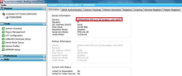

ALP GUI show the correct device information as highlighted in red
Customer change EDID to customer’s LCD panel spec and apply on the GUI. The LCD panel is “black” without any display.
Power cycle, the LCD panel still is “black ” without any display.
Customer also change internal / internal w/Ext. Clock. The situation is the same.

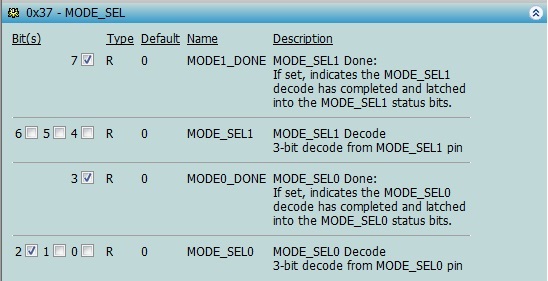

Here are the register 0x37.

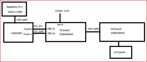

Dear Bryan,
I/m TPV-tech engineer, Alvin.
Sorry for the wrong picture.

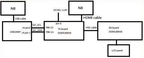

I modified the picture of hardware configuration as below,
> Use Rasberry Pi HDMI output(resolution is 1920 x 1080)
> Use NB HDMI output (output resolution is 1280 x 720).
and have a question before all.
As I stated my question as below,
1. Use Rasberry Pi HDMI output(resolution is 1920 x 1080)
Why doese this hardware configuration make the no connection?
I just connect the noraml configuration.
Because this issue leads to the setting including EDID setting that can't be executed, and even you click the item, such as pattern generator, register... by myself.
Please help to clarify this issue at first.

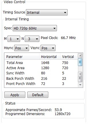

Dear Bryan,
1. How do I verifiy the setting of Timing source being saved into DS90UB949? Because I just click "Apply" and no idea save of not.
2. Are there any documents to help to clarify USB2ANY issue?
3. How to save the changed DS90UB949 timing source and EDID? Because I turn power off/on our TX/RX board (DS90UB949/948). The settings will be back to default.
I set as below, and our LCD panel can't display normally but full black.
DS90UB948, still Mode_sel0 = 1.275V
register, 0x37 reading as below,

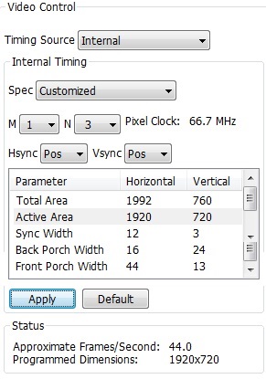

and the settings of Timing source follows our LCD panel spec. as below.

One way to confirm that the timing values being set in the Video pane above are being sent to the device would be by sniffing the i2c bus with a logic analyzer and viewing the resultant output on the display.
As for persistence with the raspberry pi, you may create a custom HDMI mode on the raspberry pi with the proper timing information. The raspberry pi will need to be modified to use this mode on device boot up.

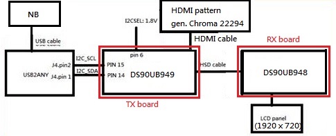

Dear Bryan,
Question:
1. Is the following register 0x37 I provided you as last response correct?
2. I try to connect HDMI source from HDMI video pattern generator "Chroma 22294", but ALP shows as below,.
What situation will the ALP recognizes the linked Deserializer and video source?
Because I think ALP doing work well and can modify other setting such as pattern generator, it is decided as linked Deserializer is OK.
Hi Alvin,

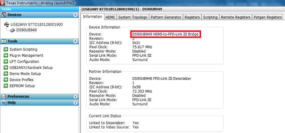

Are you experiencing a drop out of the 948 when connecting the HDMI Source? Was the 948 seen over the backchannel previously?
As shown in the screenshot above, ALP does not currently detect a link and/or the 948. Are you able to generate a test pattern with the 949 connected to the 948+display in this state? With HDMI source connected? With HDMI source removed?

Dear Bryan,
I should clarify the issue by the step for you.
As Nov 27, 2019 7:09 AM I asked you,
Question1.>
I want to ask that I set the correct EDID (Internal timing) corresponing to our LCD panel spec.
Can I check the modified EDID (Internal timing) being certainly saved in DS90UB949 by reading register 0x37 ?
Question2.>
I want to ask applying HDMI video pattern generator "Chroma 22294", and "Chroma 22294" has generated a HDMI pattern corresponding to our LCD panel spec into our DS90UB949. The hardware connection as below picture.
Will this way make ALP tool detect abnormaly? Because as I showed you the picture. Link status all detect "No".
Hi SHH,
1a) Please confirm the proper EDID setting with the display manufacturer. This isn't a standard proprietary to TI.
1b) On the 949, register 0x37 is CLK_CLEAN_STS and isn't directly related to EDID. Please read register 0x48 APB_CTL and will allow you to read the APB, however, this is may only be helpful if you're loading the EDID into the SRAM of the device.
Is the display changing or static? Is EEPROM with EDID on the display or not? If the display is not changing and/or the EDID is not available on the display/not known to be proper, it may be easier to set the timing parameters with the SOC. This is discussed on the raspberry pi site linked above.
2) The HDMI should not affect the ALP, but after connecting the HDMI pattern generator, please try to power reset the 949 with PDB. This should fix stability issues seen with ALP. If issues persist, please let me know.
