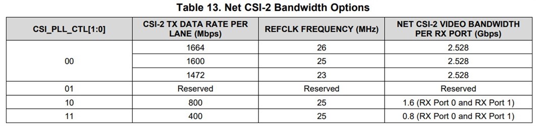

The datasheet specifies the data rate with 23/25/26MHz reference clock, is 24MHz reference clock supported? If so, what's the data rate for CSI-2 TX?

if you select 24MHz and 24*64 = 1.536Gbps/lane is designed, csi2 bandwidth is 2.528Gbps.
if you select 24MHz and 24*32 = 0.768Gbps/lane is designed, csi2 bandwidth is 1.536Gbps (RX port0 and Rx port1).
if you select 24MHz and 24*32 = 0.384Gbps/lane is designed, csi2 bandwidth is 0.768Gbps (RX port0 and Rx port1).
hopefully this can help you.
