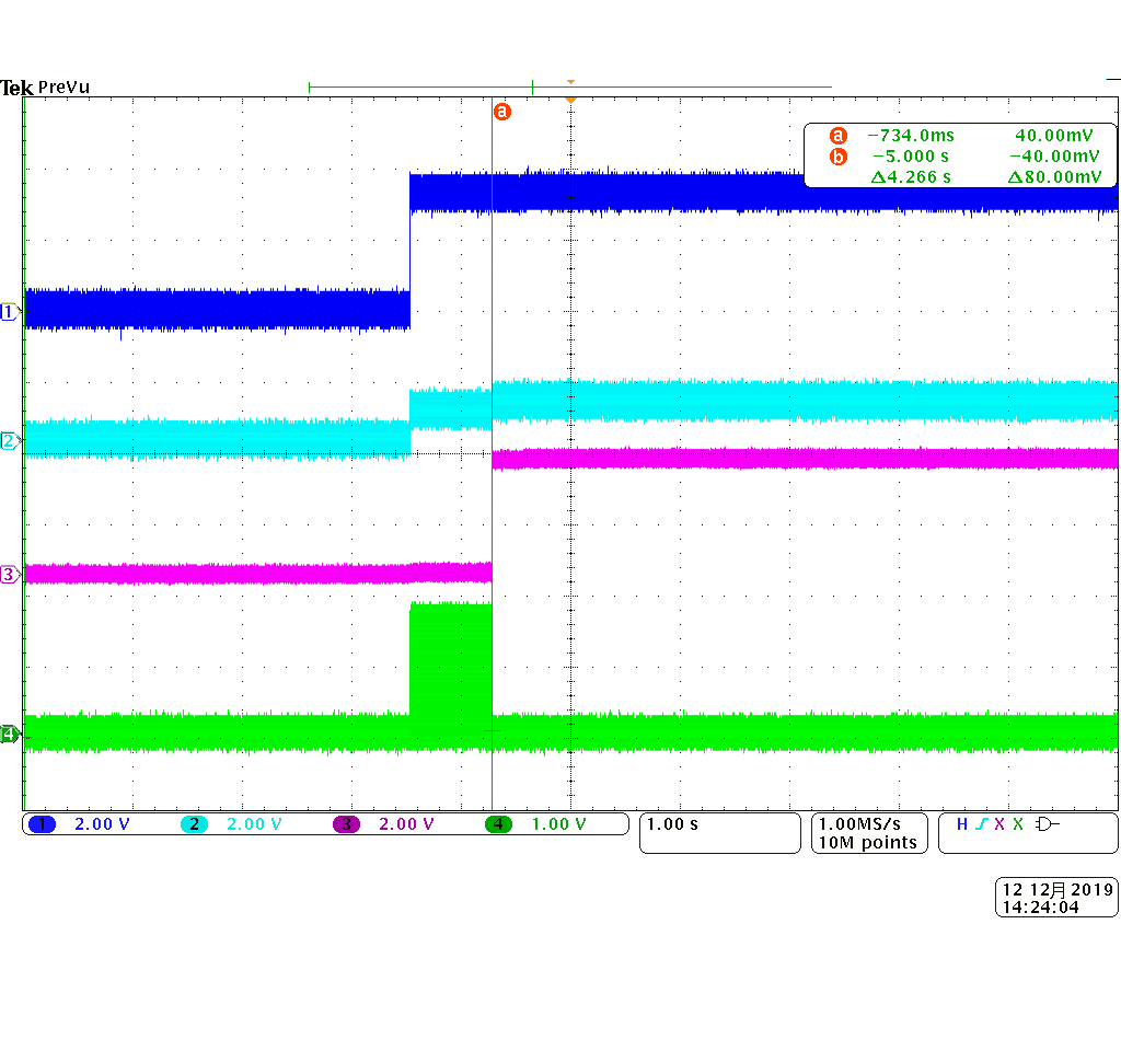

Now, the crystal for TSUB4041I did not oscillate only with the power supply and reset signal was released.
After the USB cable connected, the Crystal started to oscillate.
Is USB communicaiotn required for oscillating the crystal of TSUB4041I?
Please let me know if there is a setting terminal to oscillate the crystal continully only with power supply.

    2) Could you provide a waveform for clarification? The crystal should oscilate after GRST is released. there is no setting where the crystal will start with power supply.

    (2) Could you check the figure I attached
          CH1 (BLUE) : VDD33
          CH2 (Light BLUE) :VDD
          CH3 (PURPLE)  : GRSTz
          CH4 (Light GREEN) :Xtal output

        Could you see the same figure?
        VDD(CH2) is drop to 0.8V between powered on and GRSTz released.
        Is this behaivor correct?
    This behavior is not correct for a proper power on reset. 1.1V should be stable before GRST is released. Could you zoom in on GRST release so that we can tell?

    It's resolved.
    Sorry, This drop of VDD(1.1V) is happend by ferrite bead.
    I used the ferrite bead with High DC resistance (over than 0.05 ohm).
    See the new figure changed ferrite bead.
