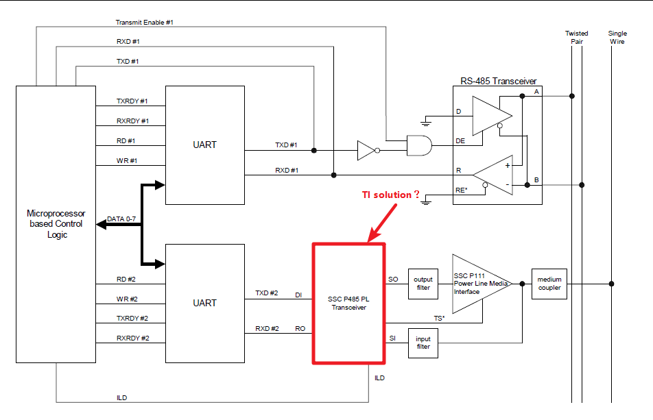

What I want to find is a Modulator (UART to PLC)...as following. Customer want to replace SSC P485
The application is customer want to design a transferred interface so that they can connect the car with PC to diagnose or debug.
Their signal chain is RS485→MCU→Modulator (UART to PLC) ...
Any device recommend?

As Max mentioned, TI doesn't have direct replacement for SSC P485. One possible solution would be SN65HVD63 that OOK modulates the TTL signal to about 2MHz, which is similar to SSC P485's 'chirp' (ASK) function. However due to the different output buffer, you may want to redesign the interface with SSC P111. Please let us know if you have more questions.
