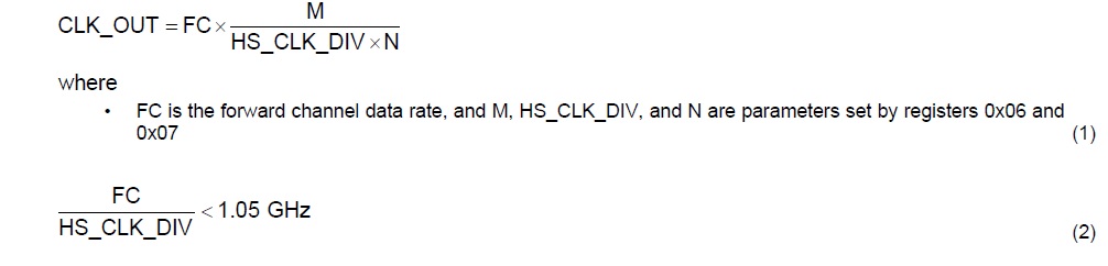

    In addition, ds90ub953-q1 modifies Reg 0x06/ 07 CSI0 to output MIPI, which seems to have an impact, but how to adjust it correctly??
    [CH] If this seems have an impact, maybe it's the issue cause, and for correct configuration:
    1st you need to know what's the PCLK the image sensor need.(refer to sensor datasheet)
    2nd you need to configure 953's CLKOUT as value above according to below equation.(also more detail you can refer to DS90UB953 datasheet's section -7.4.1.5)

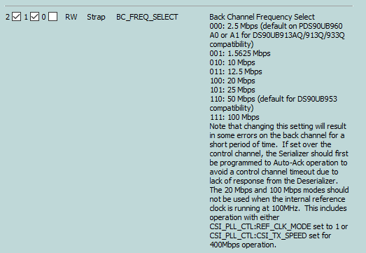

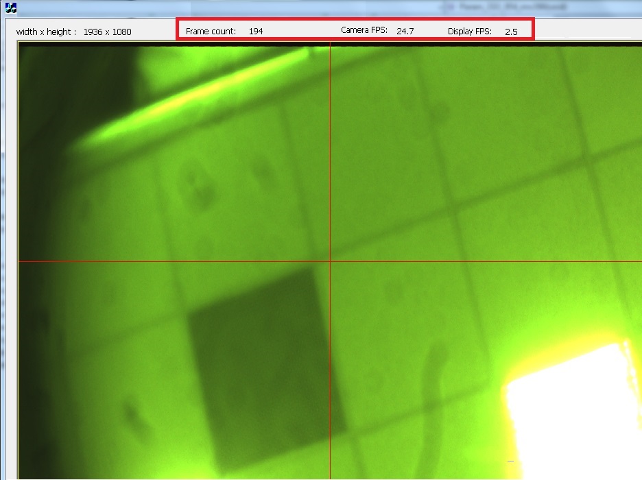

    At present, after modifying DS90UB960-Q1, reg 0x58 and 0x5C (original 0x5e), it is found that images can be obtained continuously (24.7fps), but still for a period of time (3-5 sec), the signal will be cut off and the signal transmission will be stopped!
    Will this part be a problem in the hardware circuit, or should the settings be adjusted?? Could you provide debugging suggestions?
    Amy Luo
  • Hi Amy,
    So, the stream start but after 2-3 seconds it stops? I would expect the stream to continue unless the SoC is intentionally set-up to only take in frames for 2-3 seconds and then stop.
    You seem to be capturing data from an imager, did you try running patgen? If so, what were the results, is the stream stopping after 2-3 seconds?
    Also, refer to section 7.4.25.8 in the DS90IB960-Q1 datasheet for the correct procedure on how to enable/disable CSI transmitter.
    0x58 = 0x5E is the correct value if you are using 953/960. This sets the BC frequency to 50Mbps, all you did by changing it to 0x5d is change the Back channel frequency, which you should not do. What is the document that you are referring to here? It may be outdated.

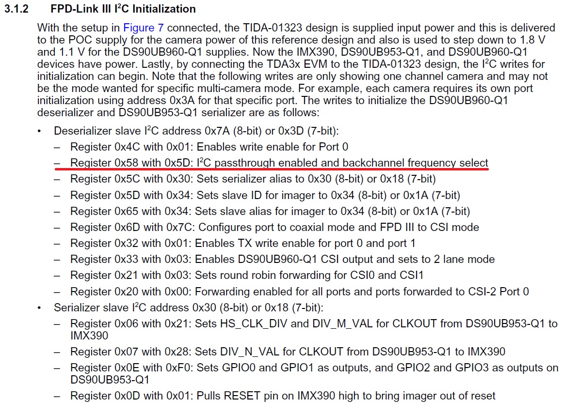

  • Hi Mandeep,
    Setting 0x58@960 = 0x5D is the recommendation of TI's Design Guide: TIDA-020002.
    In section 3.1.2 there can be found:
    – Register 0x58 with 0x5D: I2C passthrough enabled and backchannel frequency select.
    At 960 data sheet 0x58[2:0] = 101 is reserved and it seems that this value leads to a 953-960 BC rate of 25Mbps.
    But I suppose 0x5D should not be used, correct is 0x5E for 50Mbps?

  • Hi Mandeep,
    additional to last comment:
    In updated Analog Launch PAD:
    At "Registers" drop down menue of DS90UB960 value 0x5D is no longer reserved!
    Torsten
  • Hi Torsten,
    Yes, that is correct, you should have the BC speed as 50Mbps for 4G operation. In terms of ALP, the datasheet should be followed, we'll have to update that to match the datasheet.
    Mandeep Singh

  • Hi Mandeep,
    BC frequency cannot be set to 50Mbps, only 25Mbps works.
    May be there is a dependancy between Clock and BC frequency?
    Torsten
  • Hi Torsten,
    Can you expand on what you mean by why you are unable to set 50Mbps? You mean your system does not work if you have it at 50Mbps? or your unable to change the register?
    In sync mode, if you want a forward channel of 4G, then you have to use 50Mbps. Using 25Mbps will result in a 2G forward channel.
    Mandeep Singh
  • Hi Mandeep,
    we are surely able to change the register, but it does not work then.
    We used the configuration of TI for :
    960: [IMX390_D3_DES_CFG_SIZE]
    {0x58, 0x5D, 0x10}, /*Enable Back channel, set to 50Mbs*/ - with incorrect comment!
    953:[IMX390_D3_SER_CFG_SIZE]
    {0x06, 0x21, 0x1F},
    {0x07, 0x28, 0x1F},
    This leads to CLK_OUT =24MHz and FC = 1,92GHz, hence BC should be correct with 25Mbps and 50Mbps should not work?
    Torsten
  • Hi Torsten,
    I want to align, what rate do you want the Forward channel? If you want 2G, then the 25Mbps is okay to use. In sync mode, the back channel will speed of either 25Mbps or 50Mbps will set the forward channel rate. Therefore, a 25Mbps BC will give you a 2G Forward Channel.
    Mandeep Singh
