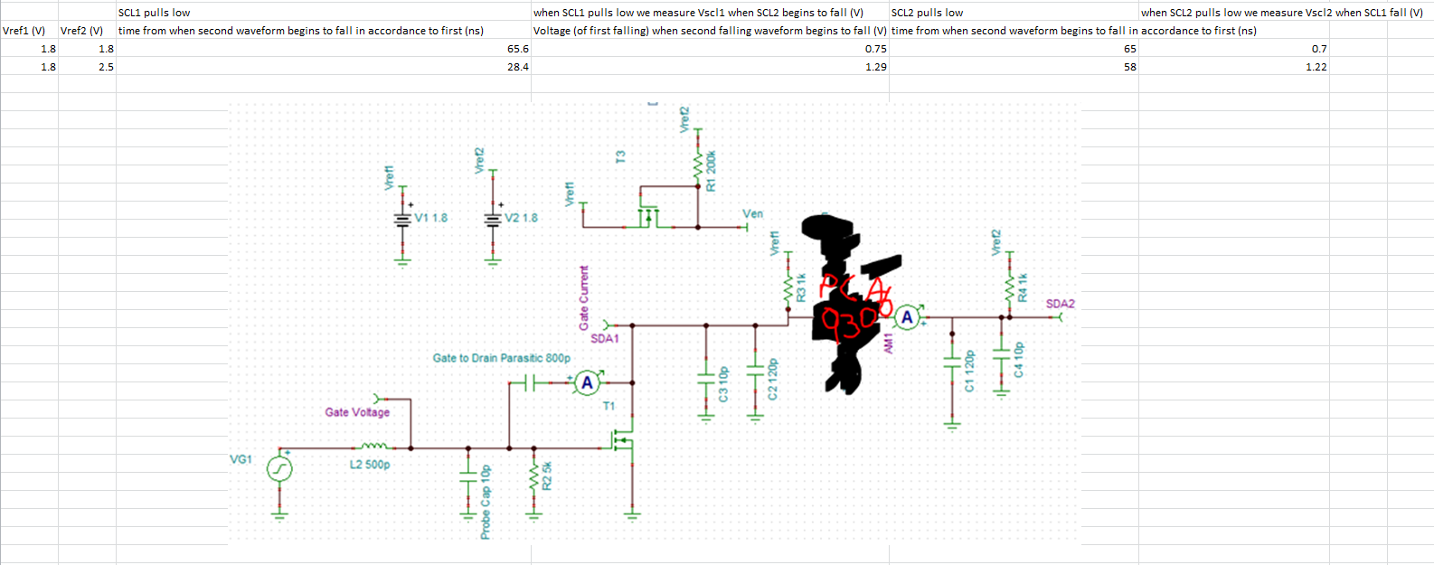

  • Another hypothetical question; if we would drive VREF2 & EN with a 2.5 or 3.3V GPIO, would this provide lower activation threshold?
    So VREF1 = 1.8V.
    SCL1 & SDA1 = Pull-up to 1.8V or driven to GND
    VREF2 & EN = 200K to 3.3V
    SCL2 & SDA2 = Pull-up to 1.8V or driven to GND
    I assume that SCL1 & SDA1 do not conduct until slightly below 1.8V (but higher than 1.2V), and that the same should be true for SCL2 and SDA2?
    But it also feels like there is something here that I might be missing.
    /Anders
  • Hey Anders,
    Similar to figure 17 where your GPIO or bias voltage is applied after the 200k resistor? If so then yes.
    So VREF1 = 1.8V.
    This set up would apply a voltage of around 2.4V directly to the EN to establish a higher reference voltage (the reason why we suggest user's to tie enable and Vref2 together). A simplified internal drawing is shown in figure 6 which when you tie a FET's gate and drain together, you essentially have just a PN junction AKA a diode.
    No, I think you hit all the spots here. I did some measurements on the prop delay differences a while back and found that the differences when the reference voltage (voltage at enable) was the same as side1 and side 2 (like a switch configuration) versus the translator configuration were pretty low. Prop delays differences were around 100ns apart.
    /Anders
    Here's measurements I took from the lab on prop delays between the EN voltage at 1.8V =Vref1=Vref2 and enable voltage at ~2.5V at Vref1=1.8V and Vref2=2.5V:
    You can see the voltages I recorded of when they start to pull low. I also made my own definition for prop delay (datasheet uses 50% of Vcc but I don't like how that is defined; instead I want to know when I pull low, how long before the other side begins to pull low).
    When side 1 and side 2 have the same voltage, the prop delay times are nearly identical. If you apply 2.5V at the reference voltage (enable pin) and pull from a 1.8V rail then the prop delay is then lower, at 28.4ns as opposed to 65ns. The voltage point at which the output follows the input changes from 0.7V to 1.2V though I'm sure if I had a slower ramp down I would see these numbers be a little higher since the switches have some double digit nanosecond range for them to turn on fully.
    -Bobby
