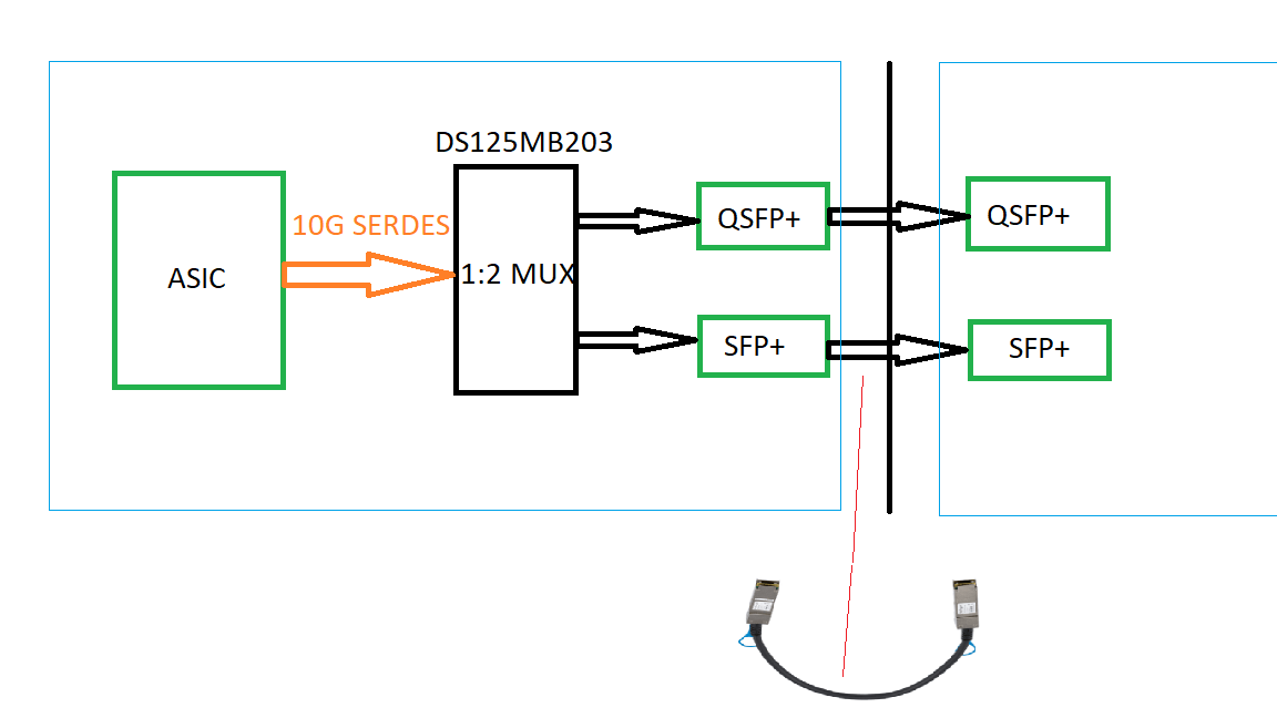

I am looking for a reference design for DS125MB203. Is any one has previews experience in using this part and faced any issues with interfacing SFP+ and QSFP+ transceivers?

    I have attached my block diagram.Could you please let me know do you see any issue with QSFP+ to QSFP+ or SFP+ to SFP+ interface with direct attache cables like shown in the attachment?Do we need to use any additional device on the path additional to 1:2 mux for my application?
    Are you also using the 2:1 Mux path in the "Right to Left" direction?
    What is the approximate attenuation in the channel between the ASIC and the MUX?
    What is the approximate attenuation in the channel between the Mux the the SFP+/QSFP+?
    Will the interface utilize an equalization training algorithm?
    Lee
  • Hi Lee,
    Please see my comments inline...
    Ans:Yes the Mux is in both directions.Our requirement is just switching between 10G and 40G path so TI suggested to use this Mux.
    Ans: Design is not yet started but I assume the trance length in between  2-3 inches
    Ans:Right now don,t have much information.Let us know your suggestions based on the above trace lengths whether it is really required or we can go ahead with defaults values.
    NR
  • Hi NR,
    With the passive DAC cables the total channel attenuation is unknown and that makes the redriver mux difficult to implement.  As Rodrigo has said a retimer is preferred in this type of solution.  The DS110DF111 is a relatively small device which has a can be programmed to have a mux-fanout function.  Otherwise, the DS125DF1610 product would work well if many signal paths are involved.
    Lee
