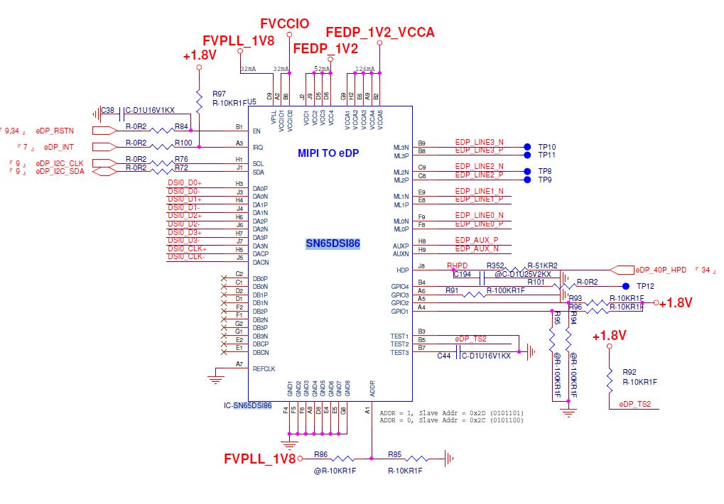

  • Hi David
    Yes, we have TEST2 pin pulled high.
    The schematic as attachment.
    Rick

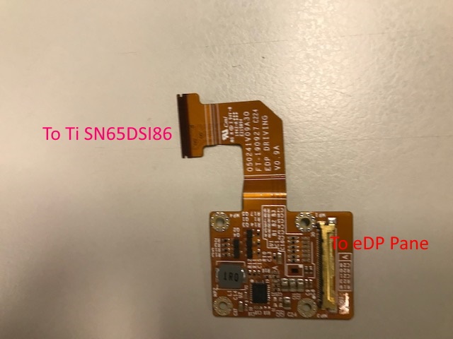

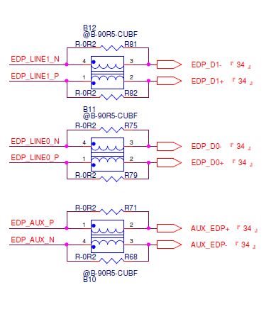

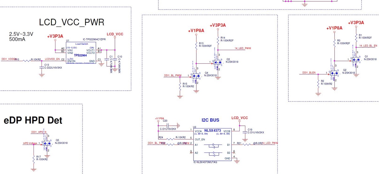

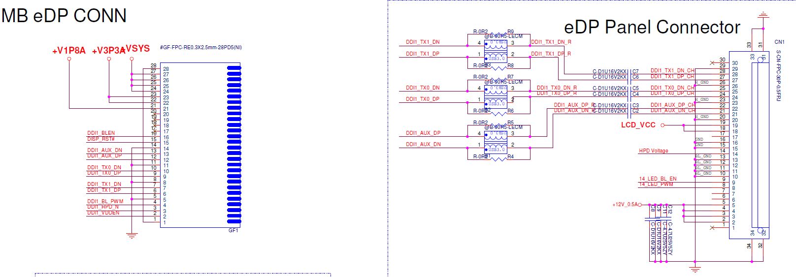

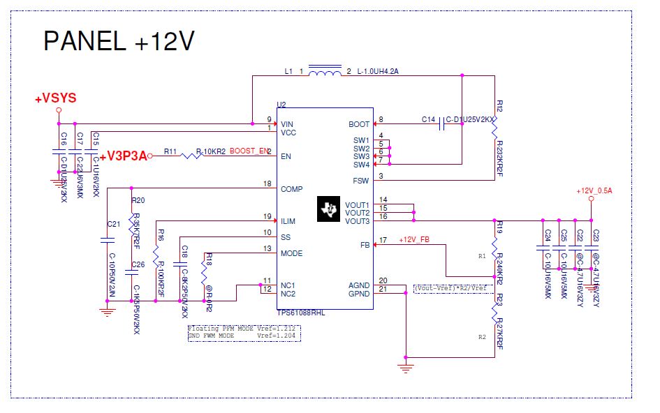

  • And We have extra board to connect between SN65DSI86 and eDP panel. The schematic also attached below.
    The board is working with panel working on our another platform (Intel CherryTrail eDP output).
  • Rick
    You have EMI on both the DSI86 part of the schematic and the eDP board, have you tried to remove the extra EMI components?
    Have you verified the DP lane order is correct? DSI86 lane 0 is connected to the eDP panel lane 0, and DSI86 lane 1 is connected to eDP panel lane 1?
    Could you please check to make sure HPD is driven high?
    Can you please send me the panel EDID info?
    David
  • Hi David
    The EMI components is removed (reserve for EMI only).
    And HPD pull-high is must? or can be ignore by disable HPD detect?
    regmap_write(pdata->regmap, 0x5C, 0x01); // disable HPD input
    The panel EDID info as attachment.

  • Rick
    Did you also check to make sure the physical connection between the EVM and the panel is correct, lane 0 goes to lane 0, lane 1 goes to lane 1, etc?
    David
